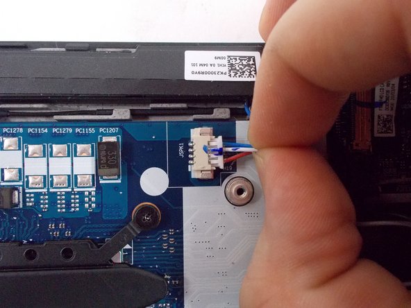

  3. Lenovo ThinkPad T495 Speaker Replacement, Speaker: crwdns2935265:03crwdnd2935265:01crwdnd2935265:03crwdne2935265:0 Lenovo ThinkPad T495 Speaker Replacement, Speaker: crwdns2935265:03crwdnd2935265:02crwdnd2935265:03crwdne2935265:0 Lenovo ThinkPad T495 Speaker Replacement, Speaker: crwdns2935265:03crwdnd2935265:03crwdnd2935265:03crwdne2935265:0
    • Grip the speaker cable as close as possible to its motherboard plug, and pull directly backwards, parallel to the motherboard, until the plug releases.
