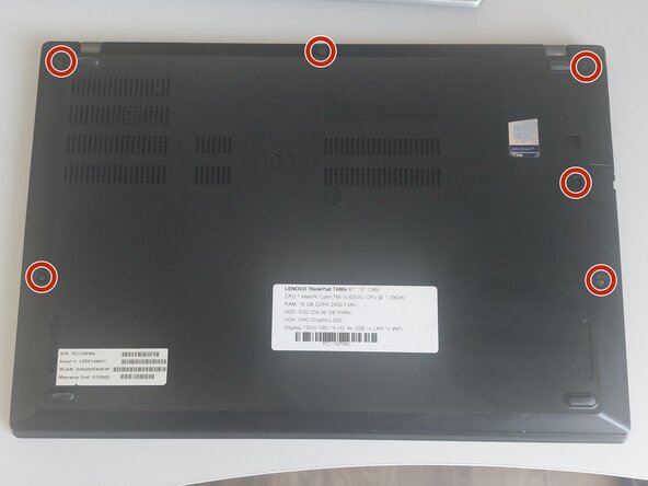

  1. Lenovo ThinkPad T480s Thermal Paste Replacement, Opening the back panel.: crwdns2935265:01crwdnd2935265:01crwdnd2935265:03crwdne2935265:0 Lenovo ThinkPad T480s Thermal Paste Replacement, Opening the back panel.: crwdns2935265:01crwdnd2935265:02crwdnd2935265:03crwdne2935265:0 Lenovo ThinkPad T480s Thermal Paste Replacement, Opening the back panel.: crwdns2935265:01crwdnd2935265:03crwdnd2935265:03crwdne2935265:0
    • Unscrew the 6 screws holding the back panel in place.
    • Use a prying tool to carefully release all the clips.
    • Once you opened the back cover, it is a good idea to upgrade the RAM or the SSD if you want.
    • It is also recommended to use compressed air to remove any dust in the laptop and the fan.

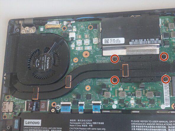

  2. Lenovo ThinkPad T480s Thermal Paste Replacement, Changing the thermal paste.: crwdns2935265:02crwdnd2935265:01crwdnd2935265:03crwdne2935265:0 Lenovo ThinkPad T480s Thermal Paste Replacement, Changing the thermal paste.: crwdns2935265:02crwdnd2935265:02crwdnd2935265:03crwdne2935265:0 Lenovo ThinkPad T480s Thermal Paste Replacement, Changing the thermal paste.: crwdns2935265:02crwdnd2935265:03crwdnd2935265:03crwdne2935265:0
    • Unscrew the 4 screws holding the CPU heatsink.
    • Clean the old thermal paste both from the cooler and the CPU. It is best to use isopropyl alcohol and cotton swabs or paper towel, but be careful not to go too hard on the CPU.
    • Don`t use too much thermal paste, just enough to cover some portion of the pad. If you have a spreader, use it. The thermal paste will apply evenly after you tighten the heatsink.
    • Last, put the heatsink back carefully and tighten the screws in order 1 -> 4 to ensure even pressure.
