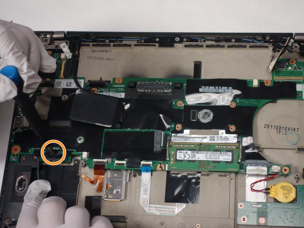

  20. Lenovo ThinkPad T470s Motherboard Replacement: crwdns2935265:020crwdnd2935265:01crwdnd2935265:02crwdne2935265:0 Lenovo ThinkPad T470s Motherboard Replacement: crwdns2935265:020crwdnd2935265:02crwdnd2935265:02crwdne2935265:0
    • Disconnect the speaker connection covering the screw.
    • Use a Phillips #0 screwdriver to remove the single 5 mm screw securing the motherboard.

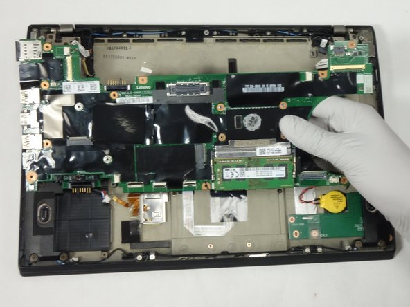

  24. Lenovo ThinkPad T470s Motherboard Replacement: crwdns2935265:024crwdnd2935265:01crwdnd2935265:02crwdne2935265:0 Lenovo ThinkPad T470s Motherboard Replacement: crwdns2935265:024crwdnd2935265:02crwdnd2935265:02crwdne2935265:0
    • Gently grip the motherboard and slide it to the right to remove the USB ports from the chassis.
    • You will hear an audible clicking sound.
    • Lift the motherboard up and out of the chassis.

There are some conections that need to be disconected before baing able to take out the board anda you did it but didnt mentioned
