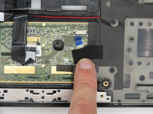

  19. Lenovo ThinkPad T430s Trackpad Replacement: crwdns2935265:019crwdnd2935265:01crwdnd2935265:02crwdne2935265:0 Lenovo ThinkPad T430s Trackpad Replacement: crwdns2935265:019crwdnd2935265:02crwdnd2935265:02crwdne2935265:0
    • Remove the right-side cable tape.
    • To disconnect the cable, use the tip of a spudger or your fingernail to flip up the small locking flap.
    • Remove the right-side cable.

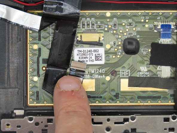

  20. Lenovo ThinkPad T430s Trackpad Replacement: crwdns2935265:020crwdnd2935265:01crwdnd2935265:02crwdne2935265:0 Lenovo ThinkPad T430s Trackpad Replacement: crwdns2935265:020crwdnd2935265:02crwdnd2935265:02crwdne2935265:0
    • Place pressure under the left cable connector.
    • Gently detach the left pin connection.
