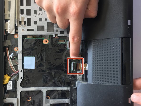

  8. Lenovo ThinkPad T410s Palm-rest Replacement, Palm-rest: crwdns2935265:08crwdnd2935265:01crwdnd2935265:01crwdne2935265:0
    • Remove the twelve Phillips #0 screws from the back panel.
  9. Lenovo ThinkPad T410s Palm-rest Replacement: crwdns2935265:09crwdnd2935265:01crwdnd2935265:02crwdne2935265:0 Lenovo ThinkPad T410s Palm-rest Replacement: crwdns2935265:09crwdnd2935265:02crwdnd2935265:02crwdne2935265:0
    • Up the flat end of a spudger to lift up the black tab on the ZIF connector.
    • Pull out the ribbon connector from the ZIF connector.
  10. Lenovo ThinkPad T410s Palm-rest Replacement: crwdns2935265:010crwdnd2935265:01crwdnd2935265:02crwdne2935265:0 Lenovo ThinkPad T410s Palm-rest Replacement: crwdns2935265:010crwdnd2935265:02crwdnd2935265:02crwdne2935265:0
    • Remove the palm rest from the laptop.
