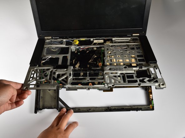

  12. Lenovo ThinkPad T400s Heatsink & Fan Replacement: crwdns2935265:012crwdnd2935265:01crwdnd2935265:02crwdne2935265:0 Lenovo ThinkPad T400s Heatsink & Fan Replacement: crwdns2935265:012crwdnd2935265:02crwdnd2935265:02crwdne2935265:0
    • Flip the computer over and open the lid. Unscrew the seven Phillips#0-4mm screws.
    • Lift the frame up by the front and pull towards you to remove.

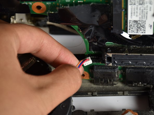

  15. Lenovo ThinkPad T400s Heatsink & Fan Replacement: crwdns2935265:015crwdnd2935265:01crwdnd2935265:02crwdne2935265:0 Lenovo ThinkPad T400s Heatsink & Fan Replacement: crwdns2935265:015crwdnd2935265:02crwdnd2935265:02crwdne2935265:0
    • Tilt up the circuit board to access the heatsink and fan.
    • Disconnect the white connector to remove.
