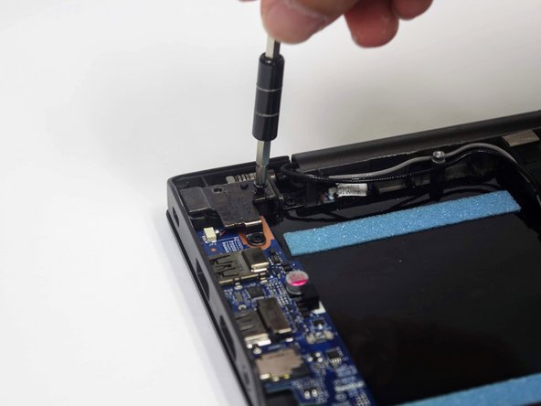

  6. Lenovo ThinkPad S431 HDMI-USB Jack assembly Replacement, HDMI-USB Jack assembly: crwdns2935265:06crwdnd2935265:01crwdnd2935265:02crwdne2935265:0 Lenovo ThinkPad S431 HDMI-USB Jack assembly Replacement, HDMI-USB Jack assembly: crwdns2935265:06crwdnd2935265:02crwdnd2935265:02crwdne2935265:0
    • Remove the 3 screws holding down the T shaped cover using the Phillips head #1. Two of the screws are M2.5x 4 wafer head. The other is a M2x4MM.
    • The two similar screws have blue threading around them.

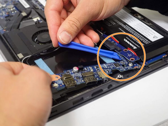

  7. Lenovo ThinkPad S431 HDMI-USB Jack assembly Replacement: crwdns2935265:07crwdnd2935265:01crwdnd2935265:02crwdne2935265:0 Lenovo ThinkPad S431 HDMI-USB Jack assembly Replacement: crwdns2935265:07crwdnd2935265:02crwdnd2935265:02crwdne2935265:0
    • Use the opening tool to lift up the T shaped cover.
    • Remove the M2x3MM wafer head screw.

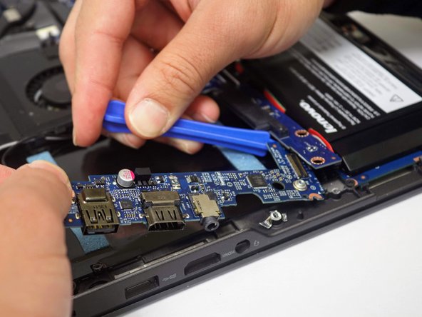

  8. Lenovo ThinkPad S431 HDMI-USB Jack assembly Replacement: crwdns2935265:08crwdnd2935265:01crwdnd2935265:03crwdne2935265:0 Lenovo ThinkPad S431 HDMI-USB Jack assembly Replacement: crwdns2935265:08crwdnd2935265:02crwdnd2935265:03crwdne2935265:0 Lenovo ThinkPad S431 HDMI-USB Jack assembly Replacement: crwdns2935265:08crwdnd2935265:03crwdnd2935265:03crwdne2935265:0
    • Take off the 2 M2x3MM wafered screws holding down the chip top of assembly.
    • Lift the chip to release the HDMI-USB jack assembly
  9. Lenovo ThinkPad S431 HDMI-USB Jack assembly Replacement: crwdns2935265:09crwdnd2935265:01crwdnd2935265:01crwdne2935265:0
    • Detach the connector.
