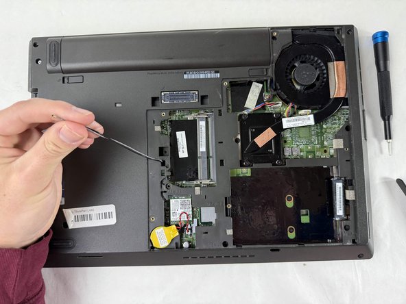

  10. Lenovo ThinkPad L440 Motherboard Replacement, CD Drive: crwdns2935265:010crwdnd2935265:01crwdnd2935265:01crwdne2935265:0
    • Remove the 6 mm CD drive set screw using a Phillips #00 screwdriver.
  11. Lenovo ThinkPad L440 Motherboard Replacement: crwdns2935265:011crwdnd2935265:01crwdnd2935265:03crwdne2935265:0 Lenovo ThinkPad L440 Motherboard Replacement: crwdns2935265:011crwdnd2935265:02crwdnd2935265:03crwdne2935265:0 Lenovo ThinkPad L440 Motherboard Replacement: crwdns2935265:011crwdnd2935265:03crwdnd2935265:03crwdne2935265:0
    • Rotate the laptop so that the CD drive is facing you.
    • Grasp the CD drive with your fingers and pull straight outwards.

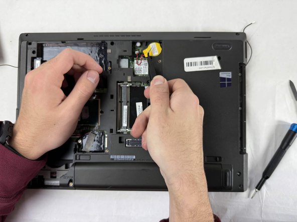

  14. Lenovo ThinkPad L440 Motherboard Replacement, Motherboard: crwdns2935265:014crwdnd2935265:01crwdnd2935265:03crwdne2935265:0 Lenovo ThinkPad L440 Motherboard Replacement, Motherboard: crwdns2935265:014crwdnd2935265:02crwdnd2935265:03crwdne2935265:0 Lenovo ThinkPad L440 Motherboard Replacement, Motherboard: crwdns2935265:014crwdnd2935265:03crwdnd2935265:03crwdne2935265:0
    • Use a pair of tweezers to detach the black and grey internet cables from the back of the computer and remove them from the coaxial connectors.
    • Remove the yellow CMOS battery from the computer.

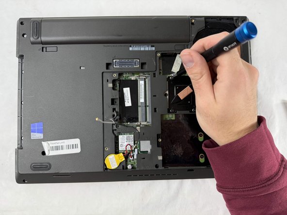

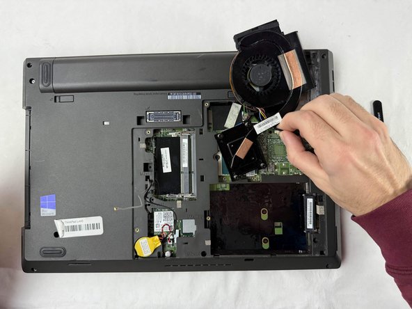

  16. Lenovo ThinkPad L440 Motherboard Replacement: crwdns2935265:016crwdnd2935265:01crwdnd2935265:03crwdne2935265:0 Lenovo ThinkPad L440 Motherboard Replacement: crwdns2935265:016crwdnd2935265:02crwdnd2935265:03crwdne2935265:0 Lenovo ThinkPad L440 Motherboard Replacement: crwdns2935265:016crwdnd2935265:03crwdnd2935265:03crwdne2935265:0
    • Fully loosen the four captive screws in the bottom left part of the heat sink.
    • Remove the sliding cable from the side of the heatsink.
    • Pull the heat sink out of the computer.

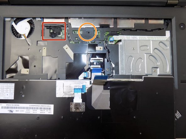

    • Flip the computer over to the front.
    • Remove the black display cable from the motherboard.
    • Remove the single 6 mm black screw in the center of the keyboard.
  18. Lenovo ThinkPad L440 Motherboard Replacement: crwdns2935265:018crwdnd2935265:01crwdnd2935265:02crwdne2935265:0 Lenovo ThinkPad L440 Motherboard Replacement: crwdns2935265:018crwdnd2935265:02crwdnd2935265:02crwdne2935265:0
    • Pull up the tab on each keyboard ribbon cable to disconnect them from the motherboard.
    • Lift the computer up and bring the internet cables from the back to the top of the computer.
    • Keep pulling on the wires following the path of the wires until they are loose from the cover for the motherboard.
