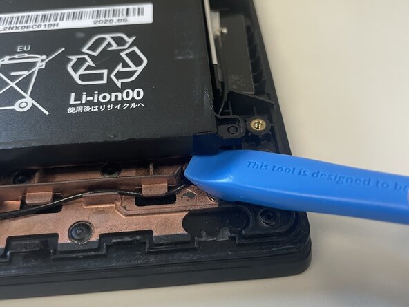

  4. Lenovo ThinkPad L390 Trackpad Replacement, Battery Removal: crwdns2935265:04crwdnd2935265:01crwdnd2935265:02crwdne2935265:0 Lenovo ThinkPad L390 Trackpad Replacement, Battery Removal: crwdns2935265:04crwdnd2935265:02crwdnd2935265:02crwdne2935265:0
    • Remove the five 4mm #00 phillips screws from the battery.
    • Lift the battery up with the opening tool.

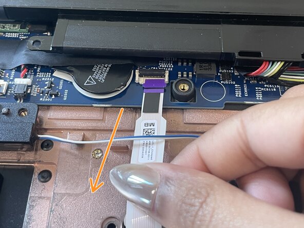

  5. Lenovo ThinkPad L390 Trackpad Replacement: crwdns2935265:05crwdnd2935265:01crwdnd2935265:02crwdne2935265:0 Lenovo ThinkPad L390 Trackpad Replacement: crwdns2935265:05crwdnd2935265:02crwdnd2935265:02crwdne2935265:0
    • Lift the black tab up to access the trackpad connector.\
    • Gently pull the trackpad connector down to detach the trackpad from the motherboard.

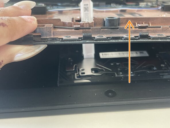

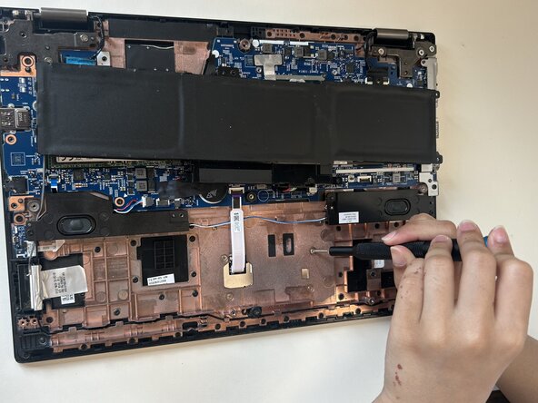

  6. Lenovo ThinkPad L390 Trackpad Replacement: crwdns2935265:06crwdnd2935265:01crwdnd2935265:03crwdne2935265:0 Lenovo ThinkPad L390 Trackpad Replacement: crwdns2935265:06crwdnd2935265:02crwdnd2935265:03crwdne2935265:0 Lenovo ThinkPad L390 Trackpad Replacement: crwdns2935265:06crwdnd2935265:03crwdnd2935265:03crwdne2935265:0
    • Remove the four 1mm #00 phillips screws from the copper cover.
    • Lift the bottom of the computer to access the detached trackpad
  7. Lenovo ThinkPad L390 Trackpad Replacement: crwdns2935265:07crwdnd2935265:01crwdnd2935265:01crwdne2935265:0
    • Congratulations, you've removed the trackpad.
