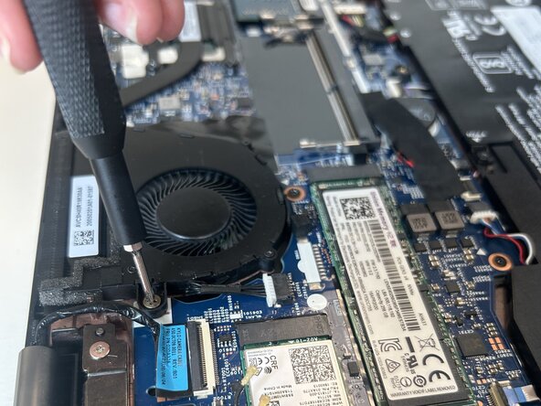

  4. Lenovo ThinkPad L390 Motherboard Replacement, Fan and Heat Sink: crwdns2935265:04crwdnd2935265:01crwdnd2935265:01crwdne2935265:0
    • Remove the four 4 mm Phillips #00 screws that secure the heat sink.
    • Remove the 6 mm Phillips #00 screw that secures the fan.
    • Do not begin to remove the fan just yet.

  6. Lenovo ThinkPad L390 Motherboard Replacement, Removing heat fan/heat sink: crwdns2935265:06crwdnd2935265:01crwdnd2935265:02crwdne2935265:0 Lenovo ThinkPad L390 Motherboard Replacement, Removing heat fan/heat sink: crwdns2935265:06crwdnd2935265:02crwdnd2935265:02crwdne2935265:0
    • Remove the 6 mm Phillips #00 screw that from the fan/heat sink as highlighted in step 4

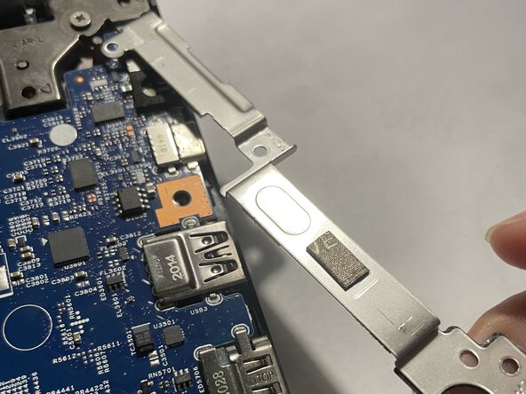

  7. Lenovo ThinkPad L390 Motherboard Replacement, Removing Side Pieces: crwdns2935265:07crwdnd2935265:01crwdnd2935265:03crwdne2935265:0 Lenovo ThinkPad L390 Motherboard Replacement, Removing Side Pieces: crwdns2935265:07crwdnd2935265:02crwdnd2935265:03crwdne2935265:0 Lenovo ThinkPad L390 Motherboard Replacement, Removing Side Pieces: crwdns2935265:07crwdnd2935265:03crwdnd2935265:03crwdne2935265:0

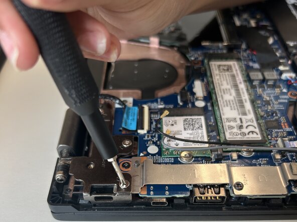

    • Remove the six 4mm #00 phillips screws that secure the metal tabs on both sides of the computer.
    • Gently lift the metal piece up and away from the computer to remove. Do this for both of the metal pieces.

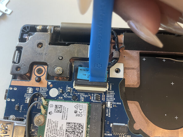

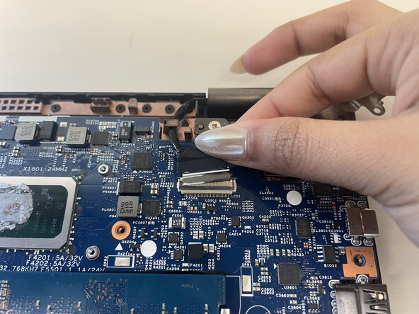

  8. Lenovo ThinkPad L390 Motherboard Replacement: crwdns2935265:08crwdnd2935265:01crwdnd2935265:03crwdne2935265:0 Lenovo ThinkPad L390 Motherboard Replacement: crwdns2935265:08crwdnd2935265:02crwdnd2935265:03crwdne2935265:0 Lenovo ThinkPad L390 Motherboard Replacement: crwdns2935265:08crwdnd2935265:03crwdnd2935265:03crwdne2935265:0

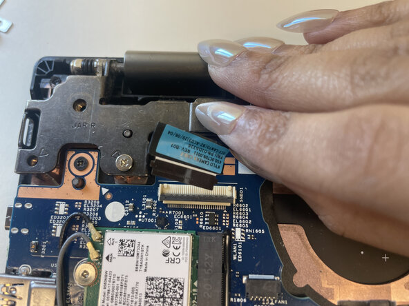

    • Use the opening tool to gently lift the black flap up and pull the display cable connector out of the socket.
  9. Lenovo ThinkPad L390 Motherboard Replacement: crwdns2935265:09crwdnd2935265:01crwdnd2935265:02crwdne2935265:0 Lenovo ThinkPad L390 Motherboard Replacement: crwdns2935265:09crwdnd2935265:02crwdnd2935265:02crwdne2935265:0
    • Continuing from step 2, on the right side of the computer, use the opening tool to gently lift the black flap up and pull the second display cable connector out of the socket.

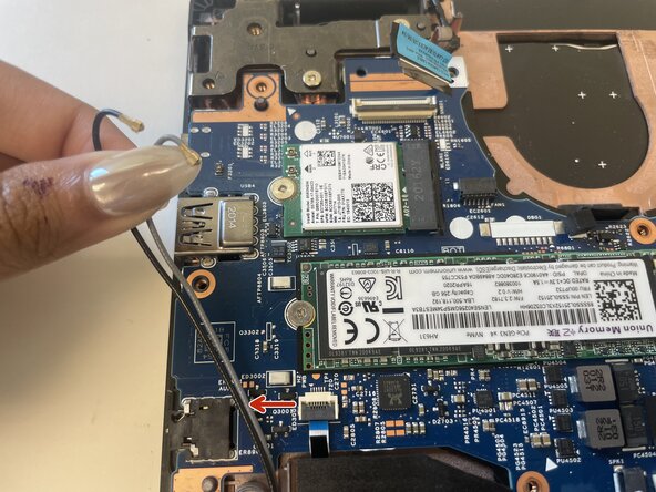

  10. Lenovo ThinkPad L390 Motherboard Replacement: crwdns2935265:010crwdnd2935265:01crwdnd2935265:03crwdne2935265:0 Lenovo ThinkPad L390 Motherboard Replacement: crwdns2935265:010crwdnd2935265:02crwdnd2935265:03crwdne2935265:0 Lenovo ThinkPad L390 Motherboard Replacement: crwdns2935265:010crwdnd2935265:03crwdnd2935265:03crwdne2935265:0

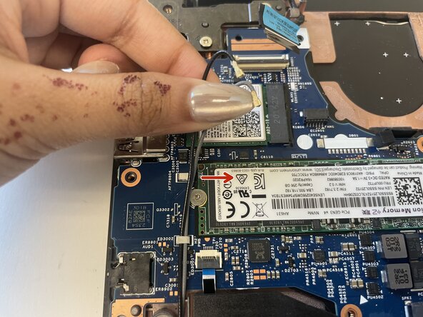

    • Gently pull the black and grey coaxial connectors from the Wi-Fi card.
    • Pull both connectors towards the right to unhook them from the metal hook located on the left side of the SSD card.
    • Pull the connectors towards the left to unhook them from the second metal hook.

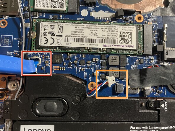

  12. Lenovo ThinkPad L390 Motherboard Replacement: crwdns2935265:012crwdnd2935265:01crwdnd2935265:03crwdne2935265:0 Lenovo ThinkPad L390 Motherboard Replacement: crwdns2935265:012crwdnd2935265:02crwdnd2935265:03crwdne2935265:0 Lenovo ThinkPad L390 Motherboard Replacement: crwdns2935265:012crwdnd2935265:03crwdnd2935265:03crwdne2935265:0

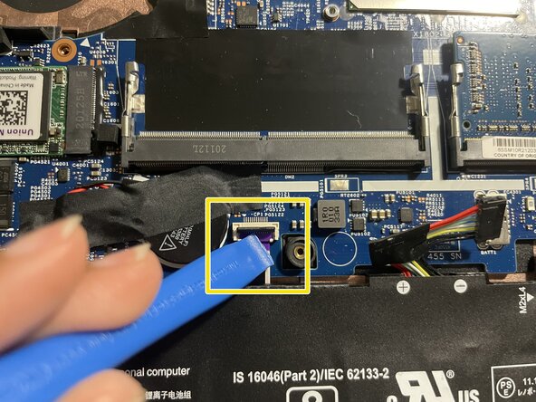

    • Gently lift the black tab with a opening tool.
    • Gently "walk" the connector out of the socket as shown in step 3.

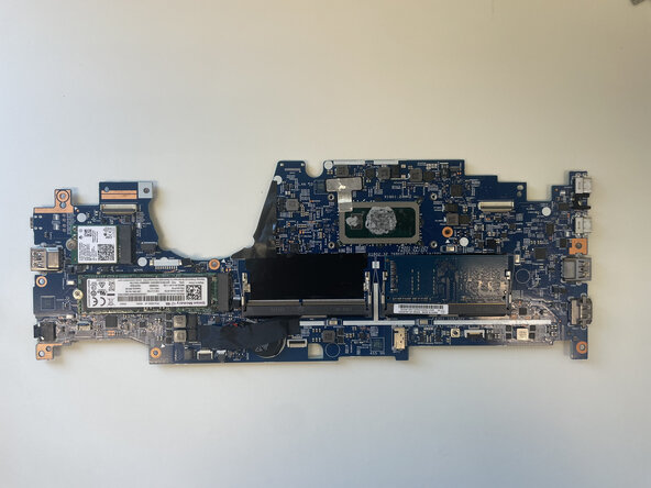

  13. Lenovo ThinkPad L390 Motherboard Replacement: crwdns2935265:013crwdnd2935265:01crwdnd2935265:02crwdne2935265:0 Lenovo ThinkPad L390 Motherboard Replacement: crwdns2935265:013crwdnd2935265:02crwdnd2935265:02crwdne2935265:0
    • Using the opening tool gently pry the top part of the motherboard up.
    • The motherboard may seem stuck at first but a little bit of force may be necessary in order to get the motherboard out.
