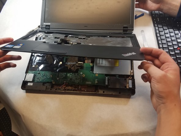

  7. Lenovo ThinkPad Edge E520 USB Drive Replacement, Front Compartment Case: crwdns2935265:07crwdnd2935265:01crwdnd2935265:01crwdne2935265:0
    • Remove all remaining screws on the back of the device.
    • Screw length 6.35 mm, head 3.175 mm Screws behind battery length 3.175 mm, head 3.175 mm
  8. Lenovo ThinkPad Edge E520 USB Drive Replacement: crwdns2935265:08crwdnd2935265:01crwdnd2935265:03crwdne2935265:0 Lenovo ThinkPad Edge E520 USB Drive Replacement: crwdns2935265:08crwdnd2935265:02crwdnd2935265:03crwdne2935265:0 Lenovo ThinkPad Edge E520 USB Drive Replacement: crwdns2935265:08crwdnd2935265:03crwdnd2935265:03crwdne2935265:0
    • Flip device back over and open the screen.
    • Insert the prying tool on one edge of the case and follow along all four edges until the case frees up.
    • Remove the case.
