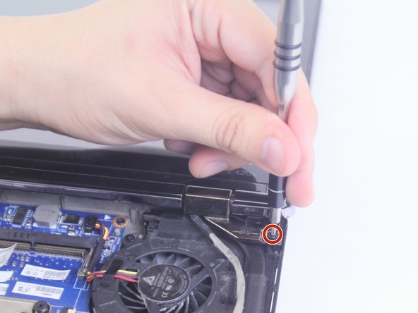

  17. Lenovo ThinkPad Edge E420s Motherboard Replacement, Glass Screen: crwdns2935265:017crwdnd2935265:01crwdnd2935265:02crwdne2935265:0 Lenovo ThinkPad Edge E420s Motherboard Replacement, Glass Screen: crwdns2935265:017crwdnd2935265:02crwdnd2935265:02crwdne2935265:0
    • Unscrew the two M2 x 3mm screws near the hinges using a Phillips #00 screwdriver.

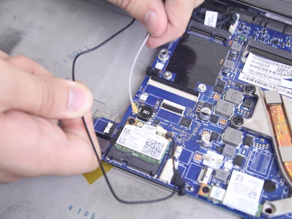

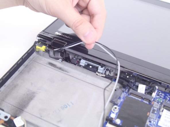

  18. Lenovo ThinkPad Edge E420s Motherboard Replacement: crwdns2935265:018crwdnd2935265:01crwdnd2935265:03crwdne2935265:0 Lenovo ThinkPad Edge E420s Motherboard Replacement: crwdns2935265:018crwdnd2935265:02crwdnd2935265:03crwdne2935265:0 Lenovo ThinkPad Edge E420s Motherboard Replacement: crwdns2935265:018crwdnd2935265:03crwdnd2935265:03crwdne2935265:0
    • Slide the black and grey wires out from underneath the plastic tab with the plastic opening tool.
    • Disconnect the black and grey wires connecting the screen and the motherboard.

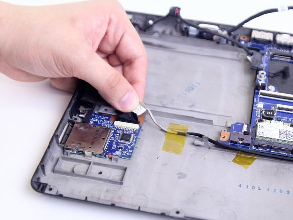

  25. Lenovo ThinkPad Edge E420s Motherboard Replacement: crwdns2935265:025crwdnd2935265:01crwdnd2935265:02crwdne2935265:0 Lenovo ThinkPad Edge E420s Motherboard Replacement: crwdns2935265:025crwdnd2935265:02crwdnd2935265:02crwdne2935265:0
    • Disconnect the cable connecting the VGA connector to the motherboard. Then disconnect the cable connecting the card reader to the motherboard.
