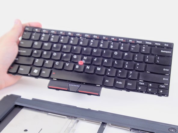

  13. Lenovo ThinkPad Edge E420s Keyboard Replacement, Keyboard: crwdns2935265:013crwdnd2935265:01crwdnd2935265:01crwdne2935265:0
    • Take the top case and turn it over so you can see the back of the keyboard.
  14. Lenovo ThinkPad Edge E420s Keyboard Replacement: crwdns2935265:014crwdnd2935265:01crwdnd2935265:01crwdne2935265:0
    • Use a plastic opening tool to push out the metal spacers holding the keyboard in place.
    • After the metal spacers have been disconnected, the keyboard may simply fall out. If not, apply a small amount of pressure to pop it off.
  15. Lenovo ThinkPad Edge E420s Keyboard Replacement: crwdns2935265:015crwdnd2935265:01crwdnd2935265:02crwdne2935265:0 Lenovo ThinkPad Edge E420s Keyboard Replacement: crwdns2935265:015crwdnd2935265:02crwdnd2935265:02crwdne2935265:0
    • Lift the keyboard away from the rest of the case.
