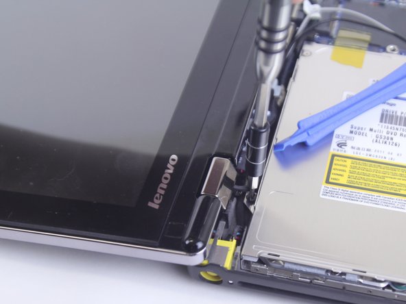

  13. Lenovo ThinkPad Edge E420s Fan Replacement, Optical Drive: crwdns2935265:013crwdnd2935265:01crwdnd2935265:02crwdne2935265:0 Lenovo ThinkPad Edge E420s Fan Replacement, Optical Drive: crwdns2935265:013crwdnd2935265:02crwdnd2935265:02crwdne2935265:0
    • Remove the two M2 x 3mm securing the the optical drive to the device using a Phillips #000 screwdriver.
  14. Lenovo ThinkPad Edge E420s Fan Replacement: crwdns2935265:014crwdnd2935265:01crwdnd2935265:01crwdne2935265:0
    • Slide the optical drive away from the motherboard in order to remove it.

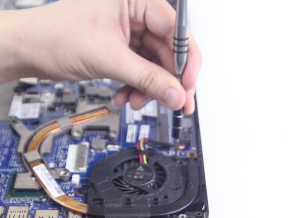

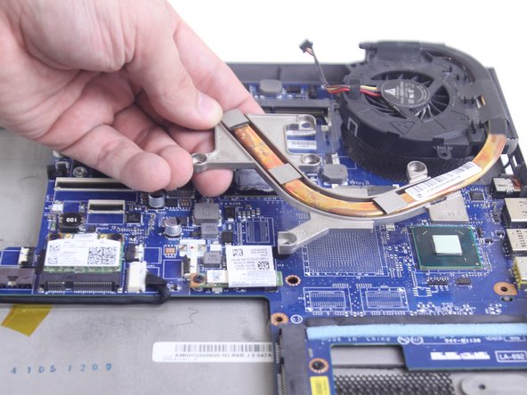

  15. Lenovo ThinkPad Edge E420s Fan Replacement, Fan: crwdns2935265:015crwdnd2935265:01crwdnd2935265:01crwdne2935265:0
    • Use a Phillips #0 screwdriver to remove the four M2 x 6mm screws connecting the heatsink to the motherboard.
  16. Lenovo ThinkPad Edge E420s Fan Replacement: crwdns2935265:016crwdnd2935265:01crwdnd2935265:02crwdne2935265:0 Lenovo ThinkPad Edge E420s Fan Replacement: crwdns2935265:016crwdnd2935265:02crwdnd2935265:02crwdne2935265:0
    • Use a Phillips #00 screwdriver to remove the two M2 x 3mm screws from the fan.
  17. Lenovo ThinkPad Edge E420s Fan Replacement: crwdns2935265:017crwdnd2935265:01crwdnd2935265:02crwdne2935265:0 Lenovo ThinkPad Edge E420s Fan Replacement: crwdns2935265:017crwdnd2935265:02crwdnd2935265:02crwdne2935265:0
    • Disconnect the cable connecting the fan to the motherboard, then remove the fan and the attached fan component from the case.
