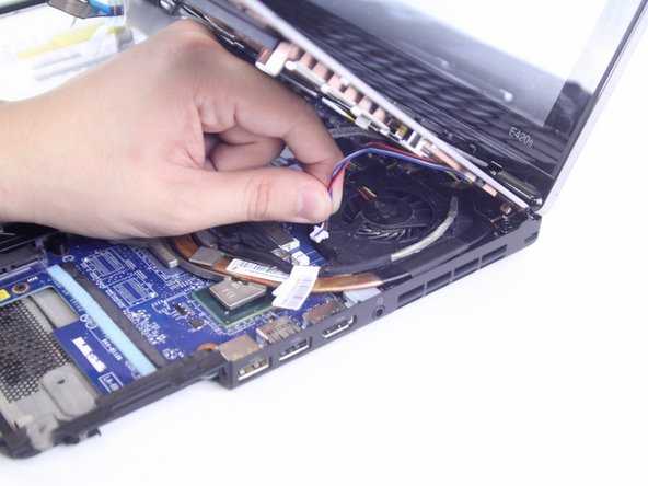

  10. Lenovo ThinkPad Edge E420s Battery Replacement: crwdns2935265:010crwdnd2935265:01crwdnd2935265:01crwdne2935265:0
    • Lift the upper half of the case up slowly.
    • Be sure not to yank any of the wires connected to the case as this could damage them.
  11. Lenovo ThinkPad Edge E420s Battery Replacement: crwdns2935265:011crwdnd2935265:01crwdnd2935265:03crwdne2935265:0 Lenovo ThinkPad Edge E420s Battery Replacement: crwdns2935265:011crwdnd2935265:02crwdnd2935265:03crwdne2935265:0 Lenovo ThinkPad Edge E420s Battery Replacement: crwdns2935265:011crwdnd2935265:03crwdnd2935265:03crwdne2935265:0
    • Locate and disconnect the 4 ribbon wires from the top case.
    • Locate and disconnect the two additional connecting wires.
    • Some wires may be connected by a clamp. In order to remove the clamp, press upwards on the lever attached to the connector
    • Be careful to not yank on the wires when disconnecting them as they are easily damaged.
  12. Lenovo ThinkPad Edge E420s Battery Replacement: crwdns2935265:012crwdnd2935265:01crwdnd2935265:01crwdne2935265:0
    • Lift the unattached case away from the device and place it to the side.
    • When reassembling ensure that all parts of the case are properly aligned.

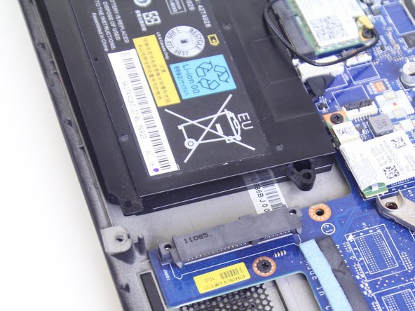

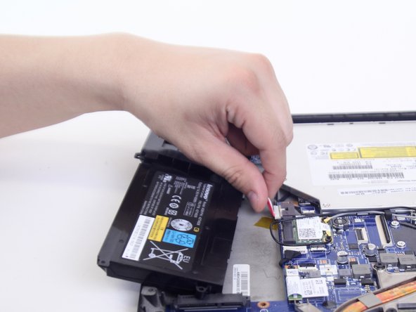

  13. Lenovo ThinkPad Edge E420s Battery Replacement, Battery: crwdns2935265:013crwdnd2935265:01crwdnd2935265:02crwdne2935265:0 Lenovo ThinkPad Edge E420s Battery Replacement, Battery: crwdns2935265:013crwdnd2935265:02crwdnd2935265:02crwdne2935265:0
    • Disconnect the cable connecting the battery and the motherboard
  14. Lenovo ThinkPad Edge E420s Battery Replacement: crwdns2935265:014crwdnd2935265:01crwdnd2935265:02crwdne2935265:0 Lenovo ThinkPad Edge E420s Battery Replacement: crwdns2935265:014crwdnd2935265:02crwdnd2935265:02crwdne2935265:0
    • Lift the battery out of the case.
    • The battery is secured by grey plastic tubes passing through the case. To place the battery back in, line up the openings on the battery with the tubes.
