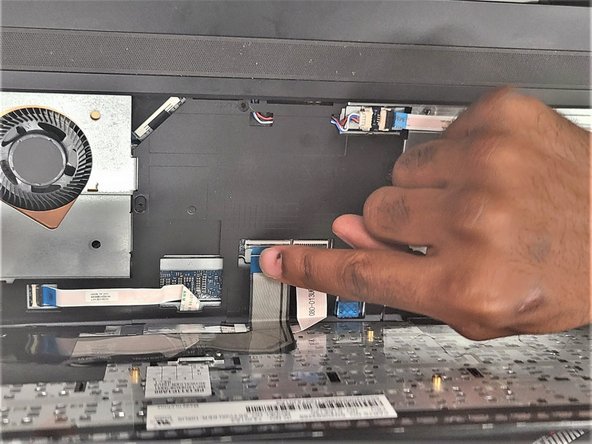

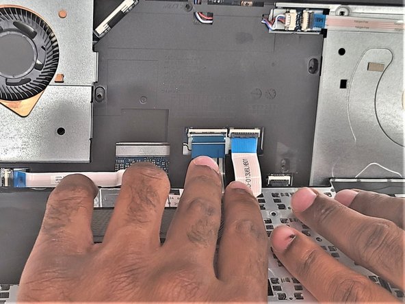

  4. Lenovo ThinkPad E570 Keyboard Replacement: crwdns2935265:04crwdnd2935265:01crwdnd2935265:01crwdne2935265:0
    • Pull up keyboard from the casing and flip it towards you to access its cables.
  5. Lenovo ThinkPad E570 Keyboard Replacement: crwdns2935265:05crwdnd2935265:01crwdnd2935265:03crwdne2935265:0 Lenovo ThinkPad E570 Keyboard Replacement: crwdns2935265:05crwdnd2935265:02crwdnd2935265:03crwdne2935265:0 Lenovo ThinkPad E570 Keyboard Replacement: crwdns2935265:05crwdnd2935265:03crwdnd2935265:03crwdne2935265:0
    • Unlatch two connector cables from the keyboards and pull the skinny black tab up to disconnect the keyboard.
