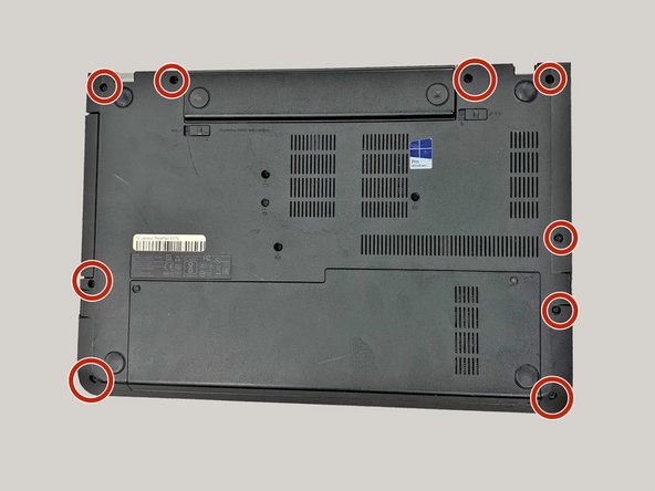

    • Remove the three 4 keyboard screws in the middle of the casing and all the outer casing screws.

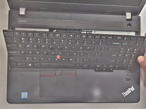

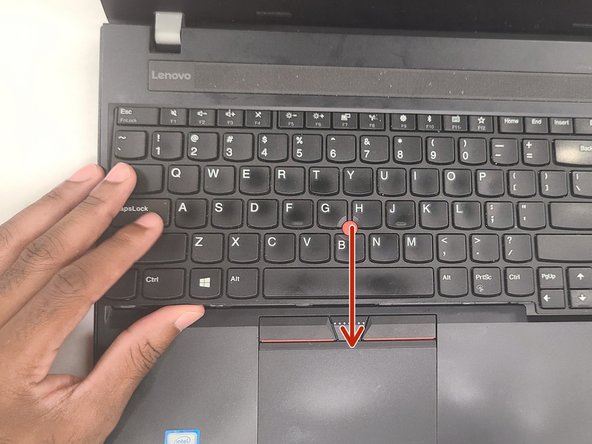

    • Gently press against the keyboard to slide it up and out. Then gently flip the keyboard over.
  10. Lenovo ThinkPad E570 Fan Replacement: crwdns2935265:011crwdnd2935265:01crwdnd2935265:03crwdne2935265:0 Lenovo ThinkPad E570 Fan Replacement: crwdns2935265:011crwdnd2935265:02crwdnd2935265:03crwdne2935265:0 Lenovo ThinkPad E570 Fan Replacement: crwdns2935265:011crwdnd2935265:03crwdnd2935265:03crwdne2935265:0
    • Disconnect the keyboard cables.

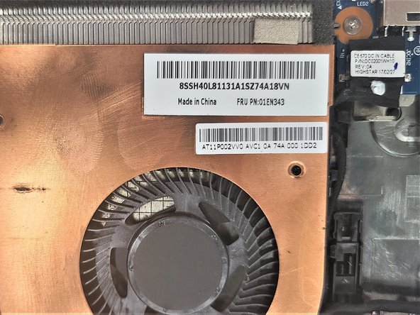

  20. Lenovo ThinkPad E570 Fan Replacement: crwdns2935265:021crwdnd2935265:01crwdnd2935265:02crwdne2935265:0 Lenovo ThinkPad E570 Fan Replacement: crwdns2935265:021crwdnd2935265:02crwdnd2935265:02crwdne2935265:0
    • Disconnect Fan connector and remove the screws from the heatsink and replace the fan. (Fan part number)
