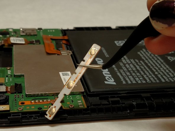

  3. Lenovo Tab 2 A8 Volume & Power Button Sensor Replacement, Volume & Power Button Sensor: crwdns2935265:03crwdnd2935265:01crwdnd2935265:02crwdne2935265:0 Lenovo Tab 2 A8 Volume & Power Button Sensor Replacement, Volume & Power Button Sensor: crwdns2935265:03crwdnd2935265:02crwdnd2935265:02crwdne2935265:0
    • Use tweezers to gently lift the button panel away from the device. Be aware that pulling on the ribbon with too much force could tear the ribbon cable.
    • Carefully desolder the button strip contact point.
