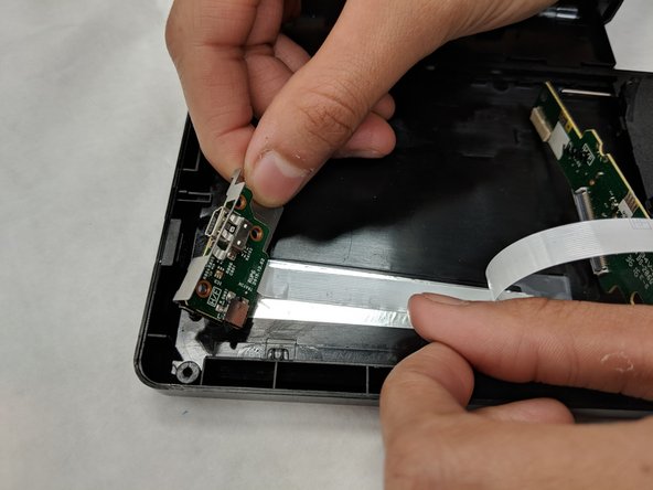

  11. Lenovo Slim DVD Burner DB65 USB 2.0 Power Assembly Replacement: crwdns2935265:011crwdnd2935265:01crwdnd2935265:02crwdne2935265:0 Lenovo Slim DVD Burner DB65 USB 2.0 Power Assembly Replacement: crwdns2935265:011crwdnd2935265:02crwdnd2935265:02crwdne2935265:0
    • Remove the power assembly by peeling it away from the unit.
    • The two circuit boards, which make up the power assembly, are connected together with a white ribbon cable.
    • Take your time when removing the power assembly, as it requires a firm amount of force to peel away and remove.
