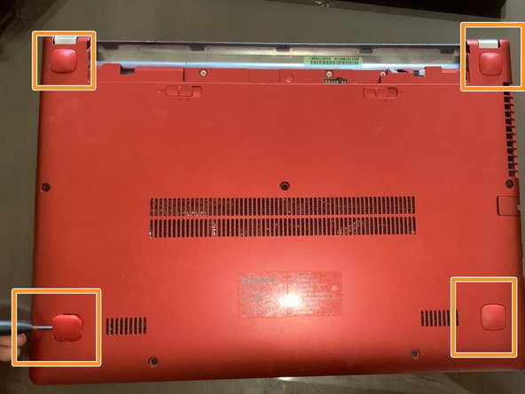

    • Turn the laptop over so the backside is facing up.
