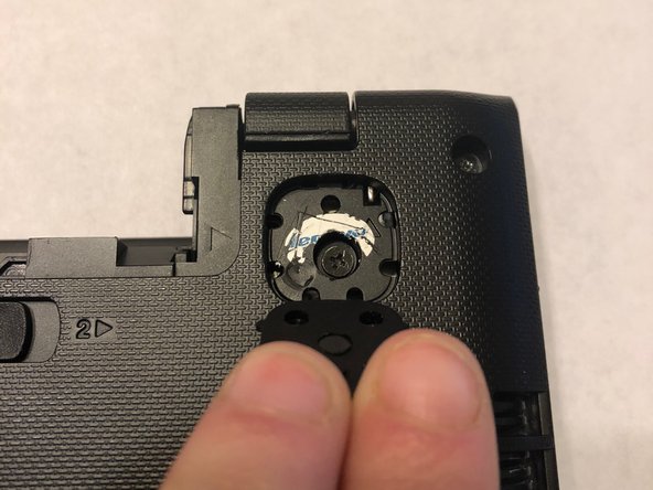

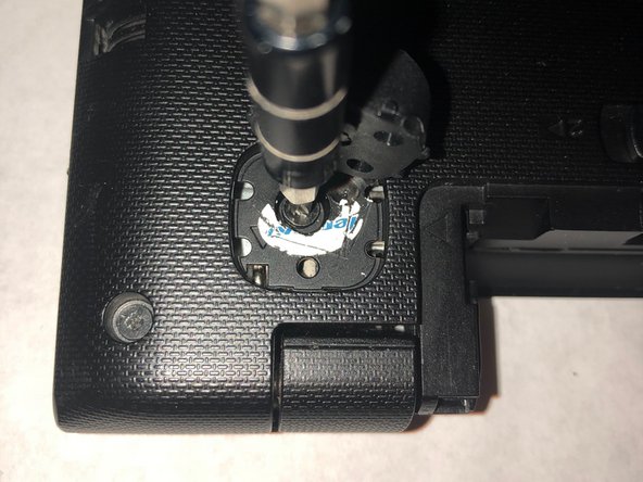

    • Remove the two front rubber feet using a long metal spudger.
    • Use your Phillips #0 screwdriver to remove the two M2.5 x 5mm flat-head screws located underneath the pads.

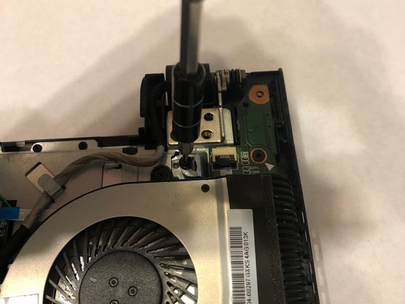

    • Remove the four M2 x 3mm flat-head screw using a Phillips #000 screwdriver.

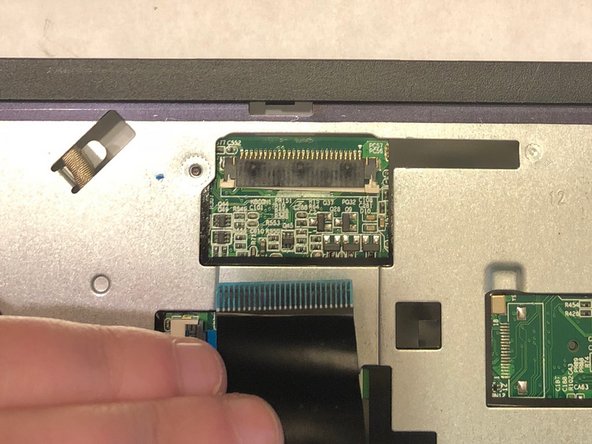

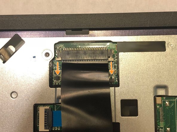

    • A connector is attached to the keyboard.
    • Remove it by gently pulling it outward.
