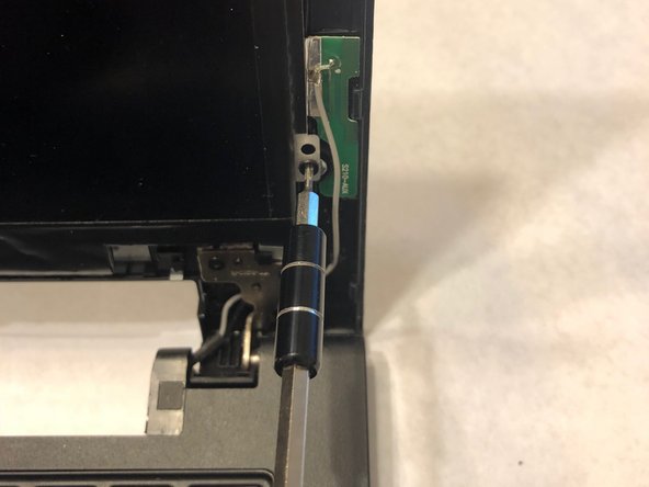

  5. Lenovo S20-30 Display Monitor Replacement: crwdns2935265:05crwdnd2935265:01crwdnd2935265:02crwdne2935265:0 Lenovo S20-30 Display Monitor Replacement: crwdns2935265:05crwdnd2935265:02crwdnd2935265:02crwdne2935265:0
    • Unscrew four M2 x 3mm screws using a Phillips #000 screwdriver.
  6. Lenovo S20-30 Display Monitor Replacement: crwdns2935265:06crwdnd2935265:01crwdnd2935265:02crwdne2935265:0 Lenovo S20-30 Display Monitor Replacement: crwdns2935265:06crwdnd2935265:02crwdnd2935265:02crwdne2935265:0

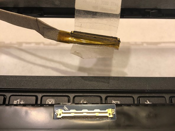

    • Slowly remove display monitor to reveal the connector.
    • Remove the connector by gently pulling it out.
  7. Lenovo S20-30 Display Monitor Replacement: crwdns2935265:07crwdnd2935265:01crwdnd2935265:01crwdne2935265:0
    • Replace with new display monitor.
