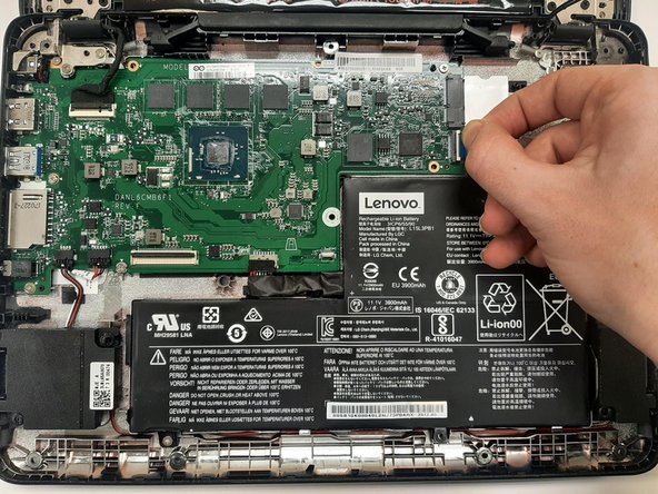

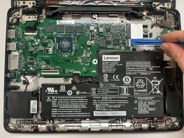

  5. Lenovo N23 Chromebook Motherboard Replacement: crwdns2935265:05crwdnd2935265:01crwdnd2935265:01crwdne2935265:0
    • Using the Phillips #0 screwdriver, remove the two 3 mm screws holding the battery in place.
  6. Lenovo N23 Chromebook Motherboard Replacement: crwdns2935265:06crwdnd2935265:01crwdnd2935265:03crwdne2935265:0 Lenovo N23 Chromebook Motherboard Replacement: crwdns2935265:06crwdnd2935265:02crwdnd2935265:03crwdne2935265:0 Lenovo N23 Chromebook Motherboard Replacement: crwdns2935265:06crwdnd2935265:03crwdnd2935265:03crwdne2935265:0
    • Disconnect the battery cable using a plastic opening tool by pulling on the black plastic lip.
    • Lift the battery out of the laptop.
