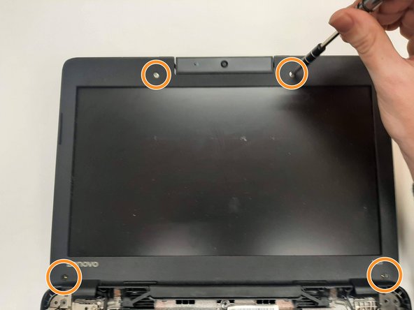

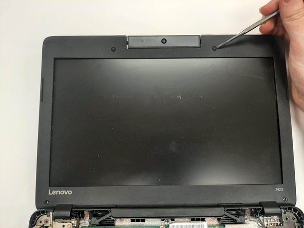

    • Remove the two rubber stoppers and two paper covers on the screen bezel using a metal spudger.
    • Remove the four 3.0 mm Phillips #0 screws holding the screen and bezel in place.

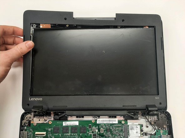

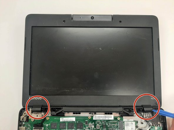

    • Use a plastic opening tool to gently pry upwards on the bezel until a small click can be heard.
    • Do this around the left, top, and right bezels. The bottom bezel is glued in place but can easily be separated by prying as well.
    • Using a plastic opening tool, press firmly at the split of both hinges until a click sound is heard and the two sides of the hinge cover are separated.
  9. Lenovo N23 Chromebook LCD Screen Replacement: crwdns2935265:09crwdnd2935265:01crwdnd2935265:03crwdne2935265:0 Lenovo N23 Chromebook LCD Screen Replacement: crwdns2935265:09crwdnd2935265:02crwdnd2935265:03crwdne2935265:0 Lenovo N23 Chromebook LCD Screen Replacement: crwdns2935265:09crwdnd2935265:03crwdnd2935265:03crwdne2935265:0
    • Using a plastic opening tool, disconnect the video cable connecting the screen to the motherboard.

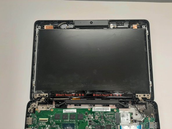

    • Pull off the bezel to view the screws holding the screen in place.

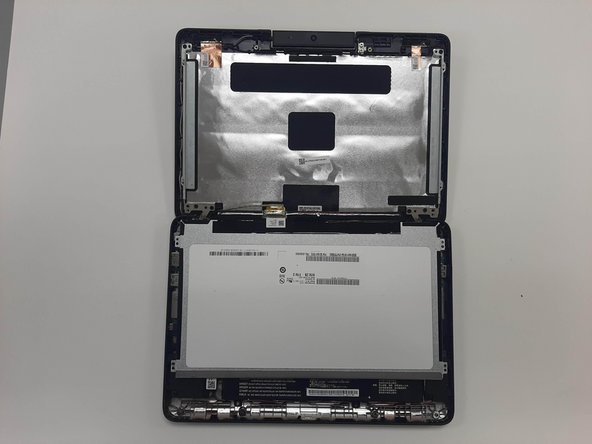

  10. Lenovo N23 Chromebook LCD Screen Replacement: crwdns2935265:010crwdnd2935265:01crwdnd2935265:03crwdne2935265:0 Lenovo N23 Chromebook LCD Screen Replacement: crwdns2935265:010crwdnd2935265:02crwdnd2935265:03crwdne2935265:0 Lenovo N23 Chromebook LCD Screen Replacement: crwdns2935265:010crwdnd2935265:03crwdnd2935265:03crwdne2935265:0
    • Remove the four 3.0 mm screws holding the screen in place using a Phillips #0 screwdriver.
    • Using an iFixit opening tool, carefully lift the screen from the screen mount bracket and place it facedown where the keyboard would usually rest.

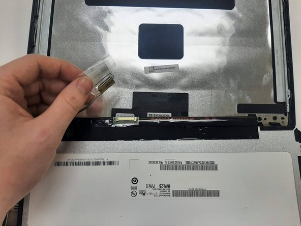

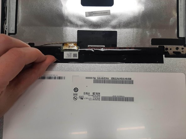

  11. Lenovo N23 Chromebook LCD Screen Replacement: crwdns2935265:011crwdnd2935265:01crwdnd2935265:03crwdne2935265:0 Lenovo N23 Chromebook LCD Screen Replacement: crwdns2935265:011crwdnd2935265:02crwdnd2935265:03crwdne2935265:0 Lenovo N23 Chromebook LCD Screen Replacement: crwdns2935265:011crwdnd2935265:03crwdnd2935265:03crwdne2935265:0
    • Peel back the tape holding the display cable connector in place.
    • Carefully pull backwards on the cable to disconnect it from the screen and lift the screen out of the laptop.
