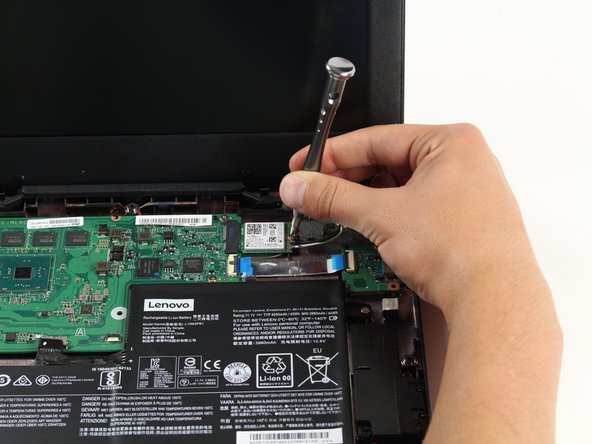

  5. Lenovo N22 Chromebook Wireless Card Replacement, Wireless Card: crwdns2935265:05crwdnd2935265:01crwdnd2935265:02crwdne2935265:0 Lenovo N22 Chromebook Wireless Card Replacement, Wireless Card: crwdns2935265:05crwdnd2935265:02crwdnd2935265:02crwdne2935265:0
    • Use a Philips #1 screwdriver to remove the 3.6 mm screw from the back panel.
  6. Lenovo N22 Chromebook Wireless Card Replacement: crwdns2935265:06crwdnd2935265:01crwdnd2935265:01crwdne2935265:0
    • Gently slide the wireless card to the right to remove it from the standard socket on the motherboard.
