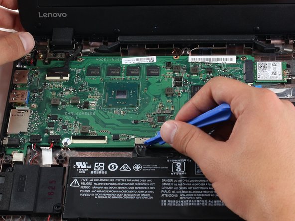

  5. Lenovo N22 Chromebook Speakers Replacement, Battery: crwdns2935265:05crwdnd2935265:01crwdnd2935265:02crwdne2935265:0 Lenovo N22 Chromebook Speakers Replacement, Battery: crwdns2935265:05crwdnd2935265:02crwdnd2935265:02crwdne2935265:0
    • Separate the battery cable from the motherboard by wedging the edge of a plastic opening tool between the black cable connector and the silver socket on the motherboard.
    • Pull the battery cable straight towards you, away from the silver socket.

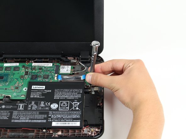

  6. Lenovo N22 Chromebook Speakers Replacement: crwdns2935265:06crwdnd2935265:01crwdnd2935265:02crwdne2935265:0 Lenovo N22 Chromebook Speakers Replacement: crwdns2935265:06crwdnd2935265:02crwdnd2935265:02crwdne2935265:0
    • Use a Philips #1 screwdriver to remove the three 4.3 mm screws securing the battery.

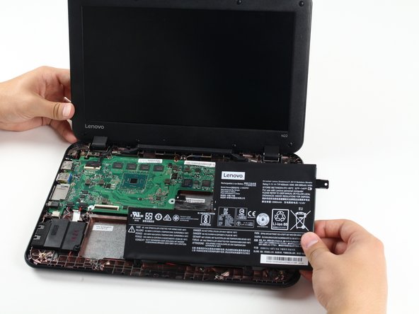

  7. Lenovo N22 Chromebook Speakers Replacement: crwdns2935265:07crwdnd2935265:01crwdnd2935265:02crwdne2935265:0 Lenovo N22 Chromebook Speakers Replacement: crwdns2935265:07crwdnd2935265:02crwdnd2935265:02crwdne2935265:0
    • Lift up on the tabs that were held down by the screws to remove the battery.

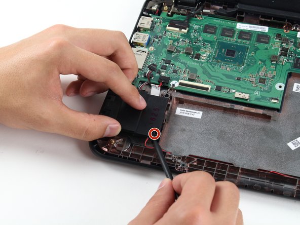

  8. Lenovo N22 Chromebook Speakers Replacement, Speakers: crwdns2935265:08crwdnd2935265:01crwdnd2935265:01crwdne2935265:0
    • Use the edge of the opening tool to separate the speaker cable connector from the black socket on the motherboard.
    • Pull the cables towards you and away from the socket.
  9. Lenovo N22 Chromebook Speakers Replacement: crwdns2935265:09crwdnd2935265:01crwdnd2935265:02crwdne2935265:0 Lenovo N22 Chromebook Speakers Replacement: crwdns2935265:09crwdnd2935265:02crwdnd2935265:02crwdne2935265:0
    • Use the pointed end of the spudger to pop the speaker up and off of the two posts.

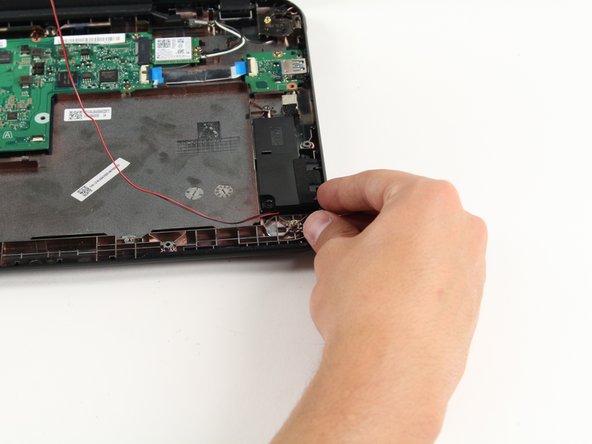

  10. Lenovo N22 Chromebook Speakers Replacement: crwdns2935265:010crwdnd2935265:01crwdnd2935265:02crwdne2935265:0 Lenovo N22 Chromebook Speakers Replacement: crwdns2935265:010crwdnd2935265:02crwdnd2935265:02crwdne2935265:0
    • Slide the wire that connects the two separate speakers out from under the guide tabs.
  11. Lenovo N22 Chromebook Speakers Replacement: crwdns2935265:011crwdnd2935265:01crwdnd2935265:02crwdne2935265:0 Lenovo N22 Chromebook Speakers Replacement: crwdns2935265:011crwdnd2935265:02crwdnd2935265:02crwdne2935265:0
    • Use the flat end of the spudger to pop the speaker up and off of the two posts.
