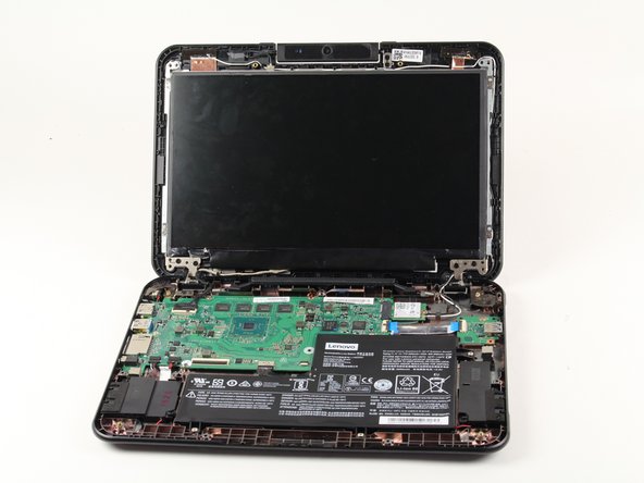

    • Lift the keyboard up and off the back panel, exposing the motherboard and battery.

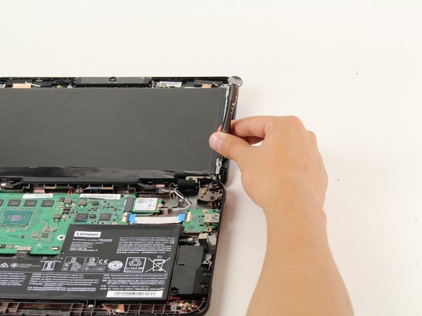

    • Open the Chromebook all the way so that the top and bottom both lay flat on the table.
    • Use the flat end of the spudger to remove the six black raised rubber circles on the front of the screen. This reveals the screws.
    • The two raised rubber circles between the laptop hinges do not need to be removed.

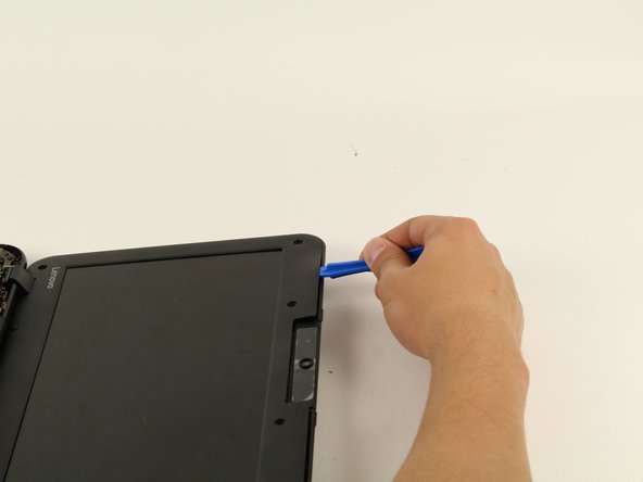

    • Place the plastic opening tool in the seam between the outer casing and the screen.
    • Run the plastic opening tool along the seam to disconnect the tabs attaching the panel to the outer casing until the panel moves freely.
    • While you run the plastic opening tool along the edge, several tabs will pop out.
    • It is normal for the tabs to make a loud click when released. The corner tabs will be harder to release than the others and will make a louder click when released.

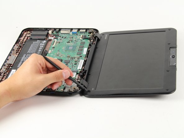

    • Remove the panel from the front casing by lifting any two corners.
    • Remove the panel slowly to prevent damaging the screen connectors. An adhesive strip holds the bottom edge of the screen casing in place.
  9. Lenovo N22 Chromebook Screen Replacement: crwdns2935265:09crwdnd2935265:01crwdnd2935265:01crwdne2935265:0
    • Disconnect the cable that connects the screen to the motherboard by flipping up the small black retaining flap on the ZIF connector.
    • Carefully pull the cable up towards the screen.

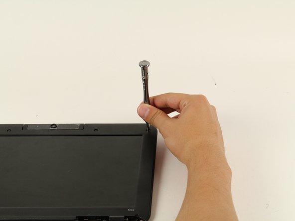

  10. Lenovo N22 Chromebook Screen Replacement: crwdns2935265:010crwdnd2935265:01crwdnd2935265:02crwdne2935265:0 Lenovo N22 Chromebook Screen Replacement: crwdns2935265:010crwdnd2935265:02crwdnd2935265:02crwdne2935265:0

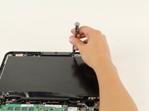

    • Use a Phillips #1 screwdriver to remove the four 2.8 mm screws at each corner of the screen. Turn the screwdriver to the left to remove the screws.
  11. Lenovo N22 Chromebook Screen Replacement: crwdns2935265:011crwdnd2935265:01crwdnd2935265:02crwdne2935265:0 Lenovo N22 Chromebook Screen Replacement: crwdns2935265:011crwdnd2935265:02crwdnd2935265:02crwdne2935265:0
    • Use a Phillips #1 screwdriver to remove the two 2.8 mm screws to the right of the camera. Turn the screwdriver to the left to remove the screws.

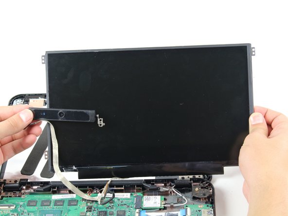

    • When you lift the screen and camera out of the back casing there will be an adhesive that keeps the screen and camera attached to the metal panel. Lift the screen slowly so you do not damage the metal panel or screen.
    • Slowly peel back the camera adhesive cable from the metal panel to fully remove the screen and camera.
