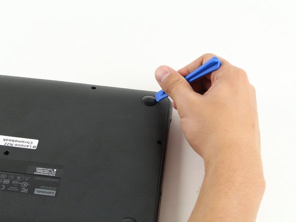

    • Use a spudger to remove each of the 4 rubber feet.
    • Use a Phillips #1 screwdriver to remove the four additional screws under the rubber feet.

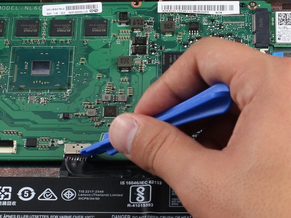

  5. Lenovo N22 Chromebook Motherboard Replacement, Motherboard: crwdns2935265:05crwdnd2935265:01crwdnd2935265:03crwdne2935265:0 Lenovo N22 Chromebook Motherboard Replacement, Motherboard: crwdns2935265:05crwdnd2935265:02crwdnd2935265:03crwdne2935265:0 Lenovo N22 Chromebook Motherboard Replacement, Motherboard: crwdns2935265:05crwdnd2935265:03crwdnd2935265:03crwdne2935265:0

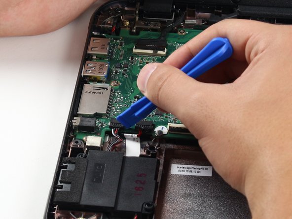

    • Disconnect the speaker and battery cables from their sockets on the motherboard by using the edge of the plastic opening tool to separate the cable connectors from the sockets.
    • Pull the cables towards you and away from the sockets.

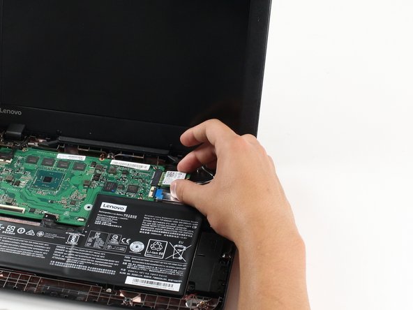

  6. Lenovo N22 Chromebook Motherboard Replacement: crwdns2935265:06crwdnd2935265:01crwdnd2935265:03crwdne2935265:0 Lenovo N22 Chromebook Motherboard Replacement: crwdns2935265:06crwdnd2935265:02crwdnd2935265:03crwdne2935265:0 Lenovo N22 Chromebook Motherboard Replacement: crwdns2935265:06crwdnd2935265:03crwdnd2935265:03crwdne2935265:0

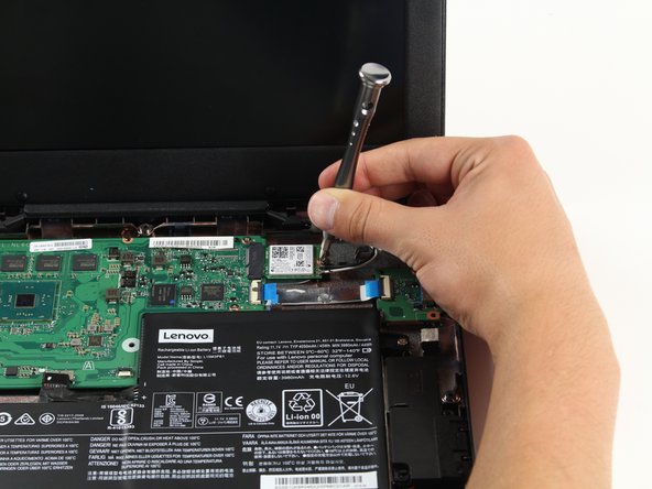

    • Use a Phillips #1 screwdriver to remove the 3.6 mm screw in the wireless card.
    • Gently slide the wireless card to the right to remove it from the standard socket on the motherboard.

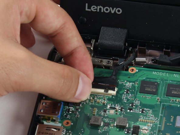

  7. Lenovo N22 Chromebook Motherboard Replacement: crwdns2935265:07crwdnd2935265:01crwdnd2935265:02crwdne2935265:0 Lenovo N22 Chromebook Motherboard Replacement: crwdns2935265:07crwdnd2935265:02crwdnd2935265:02crwdne2935265:0
    • Disconnect the display cable from the motherboard by lifting up the black ZIF connector retaining flap.
    • Gently pull the cable up towards the screen.

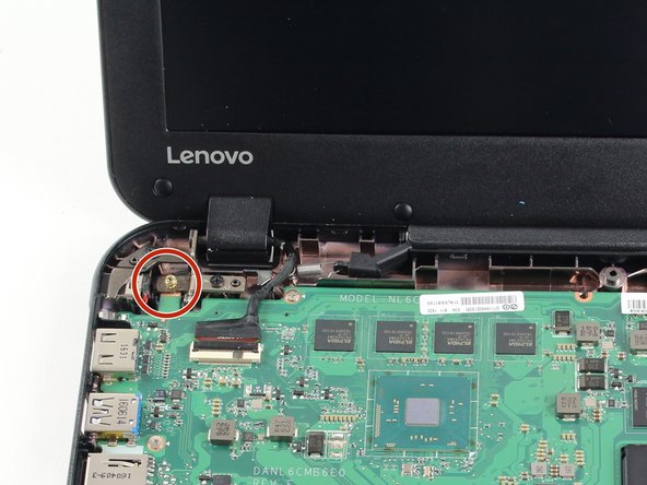

    • Flip the laptop on its top so that the screen is facing up and the back panel is bent at a 90 degree angle. This will allow you to see both the gold nut and the screw.
    • Hold the gold nut steady with a pair of needle nose pliers.
    • While holding onto the gold nut on the motherboard, remove the 6.5 mm screw on the bottom of the chromebook by rotating the Phillips #1 screwdriver to the left.
    • You may need an extra pair of hands for this step.

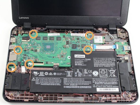

    • Remove the Lenovo sticker on top of the screw.

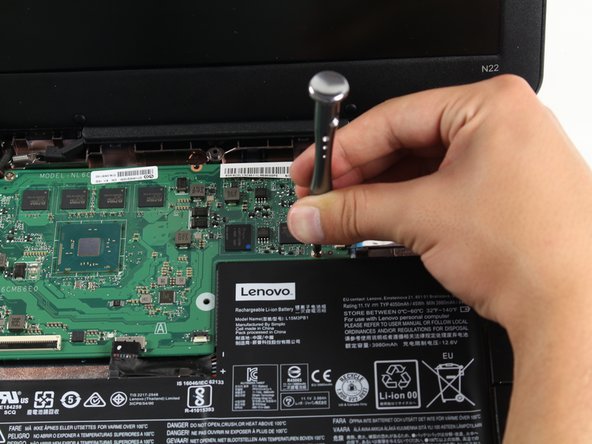

    • Use a Phillips #1 screwdriver to remove the six 3.6 mm screws from the motherboard.
  12. Lenovo N22 Chromebook Motherboard Replacement: crwdns2935265:012crwdnd2935265:01crwdnd2935265:01crwdne2935265:0
    • Carefully lift the motherboard up and out of the back panel to remove it.

The gold “nuts” as you describe them should not remain inside the machine. Those are the keyboard mounts and should have be removed when the keyboard was removed. They should have remained inside the keyboard itself.
