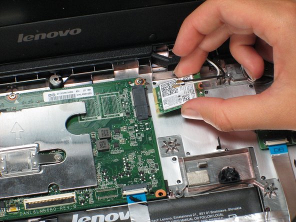

  8. Lenovo N21 Chromebook WiFi Card Replacement, WiFi Card: crwdns2935265:08crwdnd2935265:01crwdnd2935265:02crwdne2935265:0 Lenovo N21 Chromebook WiFi Card Replacement, WiFi Card: crwdns2935265:08crwdnd2935265:02crwdnd2935265:02crwdne2935265:0
    • Use a screwdriver to remove the single 3mm Phillips screw that is holding the WiFi card in place.

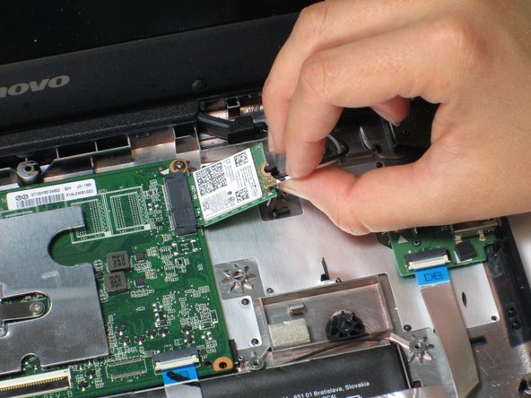

  9. Lenovo N21 Chromebook WiFi Card Replacement: crwdns2935265:09crwdnd2935265:01crwdnd2935265:02crwdne2935265:0 Lenovo N21 Chromebook WiFi Card Replacement: crwdns2935265:09crwdnd2935265:02crwdnd2935265:02crwdne2935265:0
    • Remove the black and white wires attached to WiFi card by gently lifting them upwards.
    • When re-attaching the wires, make sure they are in the correct placement. You do not want to switch the black and white wires.
  10. Lenovo N21 Chromebook WiFi Card Replacement: crwdns2935265:010crwdnd2935265:01crwdnd2935265:02crwdne2935265:0 Lenovo N21 Chromebook WiFi Card Replacement: crwdns2935265:010crwdnd2935265:02crwdnd2935265:02crwdne2935265:0
    • Remove the WiFi card by pulling it straight out of its connector.
    • Keep the WiFi card horizontal and pull straight back to avoid causing the part harm.
