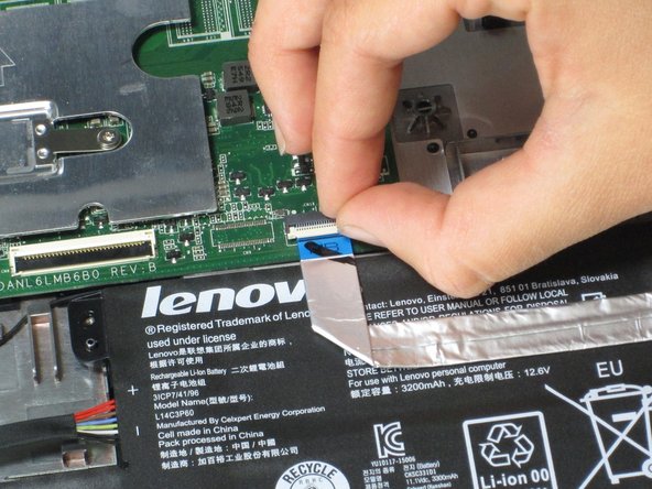

    • Disconnect the keyboard ribbon cable by lifting the ZIF connector lock with a plastic opening tool or fingernail and gently pulling the ribbon cable straight out of its socket.
  6. Lenovo N21 Chromebook Motherboard and Camera Replacement: crwdns2935265:06crwdnd2935265:01crwdnd2935265:03crwdne2935265:0 Lenovo N21 Chromebook Motherboard and Camera Replacement: crwdns2935265:06crwdnd2935265:02crwdnd2935265:03crwdne2935265:0 Lenovo N21 Chromebook Motherboard and Camera Replacement: crwdns2935265:06crwdnd2935265:03crwdnd2935265:03crwdne2935265:0
    • Disconnect the trackpad ribbon cable by lifting the ZIF connector lock with a small prying tool or fingernail and gently pulling the ribbon cable straight out of its socket.

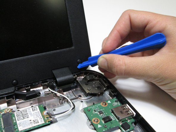

  9. Lenovo N21 Chromebook Motherboard and Camera Replacement: crwdns2935265:09crwdnd2935265:01crwdnd2935265:02crwdne2935265:0 Lenovo N21 Chromebook Motherboard and Camera Replacement: crwdns2935265:09crwdnd2935265:02crwdnd2935265:02crwdne2935265:0
    • Remove the black and white wires attached to WiFi card by gently lifting them upwards.
    • When re-attaching the wires, make sure they are in the correct placement. You do not want to switch the black and white wires.

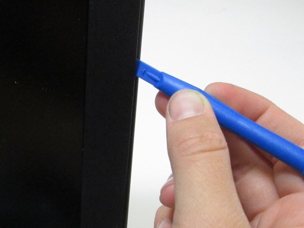

    • Use a plastic opening tool to carefully pry the thin plastic frame away from the screen.
    • The bottom edge of the frame has adhesive on it, and will take a little more power to peel away. Be careful not to bend the plastic too far or it will snap.

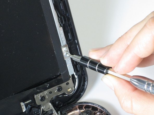

    • Remove the four 3.0mm Phillips screws symmetrically placed on either side of the screen.

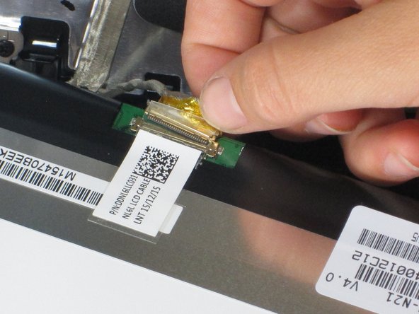

    • Pull the cable connecting the motherboard to the screen straight out from the back of the screen.
    • The screen is very fragile. When handling it, avoid applying uneven pressure on or bending the screen.

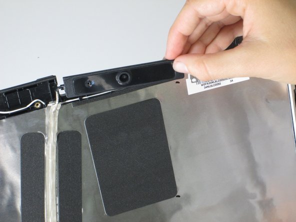

  17. Lenovo N21 Chromebook Motherboard and Camera Replacement, Motherboard and Camera: crwdns2935265:017crwdnd2935265:01crwdnd2935265:02crwdne2935265:0 Lenovo N21 Chromebook Motherboard and Camera Replacement, Motherboard and Camera: crwdns2935265:017crwdnd2935265:02crwdnd2935265:02crwdne2935265:0
    • Remove the two 4.0 mm Phillips screws from the right side of the camera.
    • Once the two screws are removed, carefully pull the camera off the top of the screen.

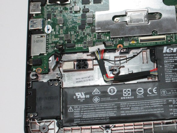

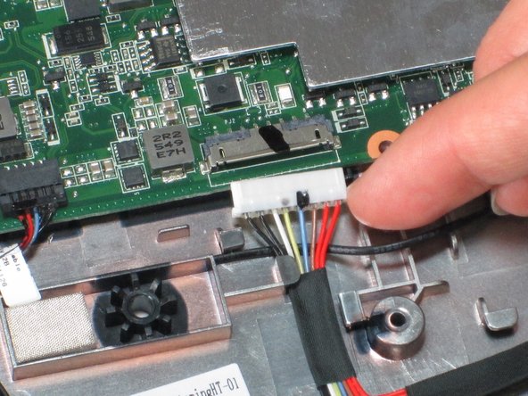

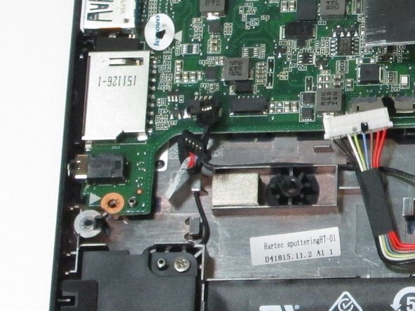

    • Disconnect the battery by pulling the battery cable connector straight out.
  19. Lenovo N21 Chromebook Motherboard and Camera Replacement: crwdns2935265:019crwdnd2935265:01crwdnd2935265:02crwdne2935265:0 Lenovo N21 Chromebook Motherboard and Camera Replacement: crwdns2935265:019crwdnd2935265:02crwdnd2935265:02crwdne2935265:0
    • Disconnect the USB cable from its ZIF connector by lifting up on the ZIF tab and pulling the cable straight out.
  20. Lenovo N21 Chromebook Motherboard and Camera Replacement: crwdns2935265:020crwdnd2935265:01crwdnd2935265:02crwdne2935265:0 Lenovo N21 Chromebook Motherboard and Camera Replacement: crwdns2935265:020crwdnd2935265:02crwdnd2935265:02crwdne2935265:0
    • Disconnect the speakers by pulling the two speaker cables straight out of their connectors.
  21. Lenovo N21 Chromebook Motherboard and Camera Replacement: crwdns2935265:021crwdnd2935265:01crwdnd2935265:02crwdne2935265:0 Lenovo N21 Chromebook Motherboard and Camera Replacement: crwdns2935265:021crwdnd2935265:02crwdnd2935265:02crwdne2935265:0

    • The motherboard is now free from the bottom housing of the Chromebook.
    • The camera is still connected to the motherboard, so the camera needs to also be removed before the two components can be completely removed.
