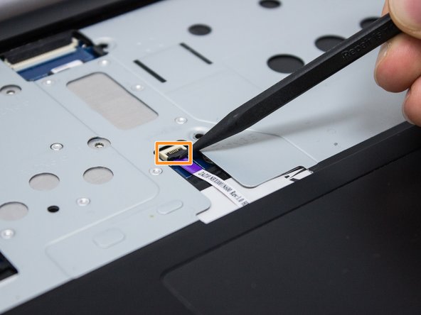

  6. Lenovo N20p Chromebook Battery Replacement: crwdns2935265:06crwdnd2935265:01crwdnd2935265:02crwdne2935265:0 Lenovo N20p Chromebook Battery Replacement: crwdns2935265:06crwdnd2935265:02crwdnd2935265:02crwdne2935265:0
    • Disconnect the battery cable from the motherboard.
    • Disconnect the touch-pad cable from the motherboard.

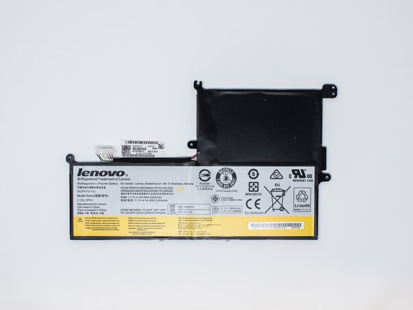

  9. Lenovo N20p Chromebook Battery Replacement: crwdns2935265:09crwdnd2935265:01crwdnd2935265:02crwdne2935265:0 Lenovo N20p Chromebook Battery Replacement: crwdns2935265:09crwdnd2935265:02crwdnd2935265:02crwdne2935265:0
    • Remove the battery.
    • It is helpful to lift and hold the battery as shown.
