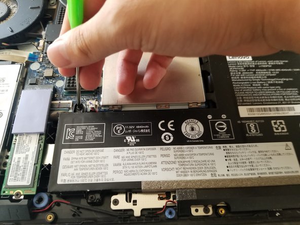

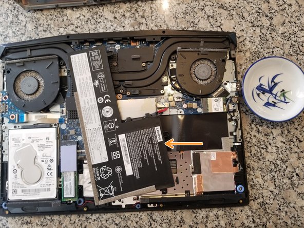

    • Remove the four screws that are holding the battery down using a Phillips #00 screwdriver.
    • Disconnect and remove the battery from the device.

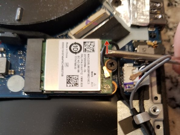

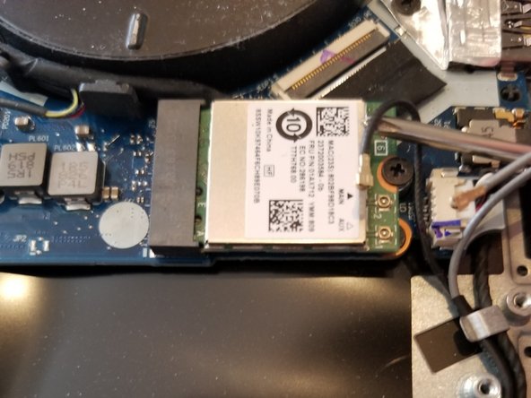

    • Using a plastic opening tool, carefully disconnect the two cables connected to the Wi-Fi card.

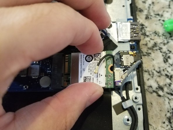

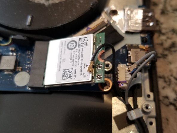

    • Using the Phillips #00 screwdriver, remove the screw holding the Wi-Fi card to the device.
    • Remove the Wi-Fi Card from the device.
