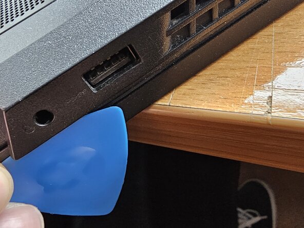

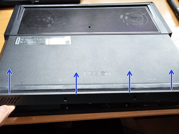

  1. Lenovo Legion Y530-15ICH Upper Case with Keyboard Replacement, Remove the base cover: crwdns2935265:01crwdnd2935265:01crwdnd2935265:03crwdne2935265:0 Lenovo Legion Y530-15ICH Upper Case with Keyboard Replacement, Remove the base cover: crwdns2935265:01crwdnd2935265:02crwdnd2935265:03crwdne2935265:0 Lenovo Legion Y530-15ICH Upper Case with Keyboard Replacement, Remove the base cover: crwdns2935265:01crwdnd2935265:03crwdnd2935265:03crwdne2935265:0
    • Remove 5 M2.0 × 8.0 mm screws
    • Remove 6 M2.0 × 4.0 mm screws
    • As you unscrew your way through this laptop, you will need an organizer for your screws. It helps me to sort them in chronological order, making reassembly easy by simply backtracking. Trust me, this is important!
    • Remove the cover by lifting from the side closest to you. But be careful! On both left and right sides, next to the USB slots, you'll find it doesn't really budge. So insert an opening pick and pry a little bit, and it'll go smoothly once again.

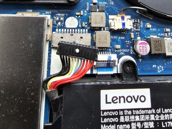

  2. Lenovo Legion Y530-15ICH Upper Case with Keyboard Replacement, Disconnect and remove the battery: crwdns2935265:02crwdnd2935265:01crwdnd2935265:03crwdne2935265:0 Lenovo Legion Y530-15ICH Upper Case with Keyboard Replacement, Disconnect and remove the battery: crwdns2935265:02crwdnd2935265:02crwdnd2935265:03crwdne2935265:0 Lenovo Legion Y530-15ICH Upper Case with Keyboard Replacement, Disconnect and remove the battery: crwdns2935265:02crwdnd2935265:03crwdnd2935265:03crwdne2935265:0
    • Remove 5 M2.0 x 5.0 mm screws
    • Detach the battery connector by pulling it away from its slot.
    • Easiest way to do this is to grab both edges with your nails and pull, or use a spudger and shimmy it out by pushing left and right side repeatedly.
    • You can also lift the battery out first to have more room to pull the connector (the wires are quite compressed there). You can just pull by the set of wires, but do be careful and don't pull too hard, or else you'll have another problem on your side.

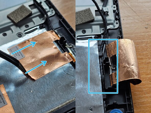

  3. Lenovo Legion Y530-15ICH Upper Case with Keyboard Replacement, Disconnect wifi card and speaker wires: crwdns2935265:03crwdnd2935265:01crwdnd2935265:03crwdne2935265:0 Lenovo Legion Y530-15ICH Upper Case with Keyboard Replacement, Disconnect wifi card and speaker wires: crwdns2935265:03crwdnd2935265:02crwdnd2935265:03crwdne2935265:0 Lenovo Legion Y530-15ICH Upper Case with Keyboard Replacement, Disconnect wifi card and speaker wires: crwdns2935265:03crwdnd2935265:03crwdnd2935265:03crwdne2935265:0
    • Disconnect the two (in my case, black and gray) wifi card cables by pulling them away from the wifi card.
    • Disconnect the speaker cable by pulling its connector out of the socket, towards the right side
    • It requires a bit of force, but easiest would be to grab it with your fingernails on its left and right side and either shimmy it out or just pull. Try not to pull on the wires.

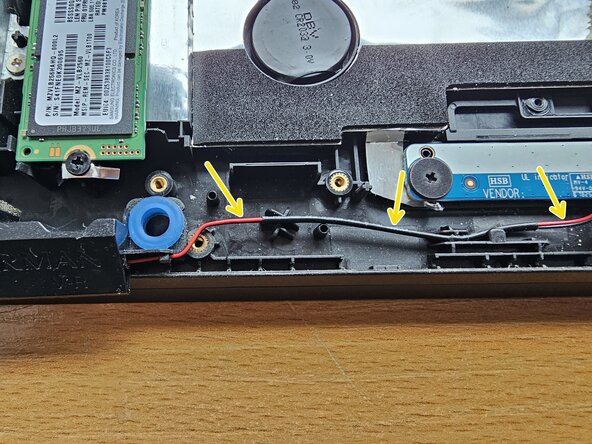

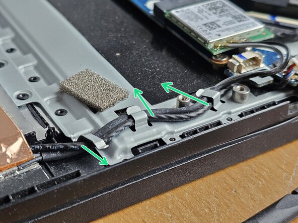

    • Detach the speaker wire from its metal holders. It is likely you will need to also move the wifi card wires, at least partly, to be able to do that.
    • You will notice that you cannot move the speaker wire due to the copper sticker. Use your fingernails or opening tools to get it going and then carefully, but firmly pull it towards the right side, to free the way for the speaker wire.
    • As a final step, pull the speaker wire out of the holders beneath the copper sticker.

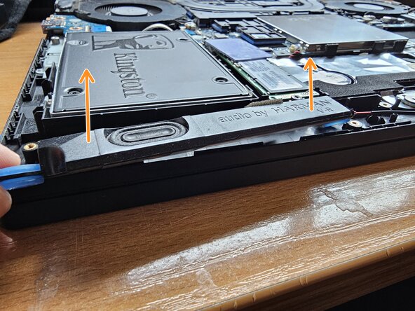

  4. Lenovo Legion Y530-15ICH Upper Case with Keyboard Replacement, Remove the speaker: crwdns2935265:04crwdnd2935265:01crwdnd2935265:03crwdne2935265:0 Lenovo Legion Y530-15ICH Upper Case with Keyboard Replacement, Remove the speaker: crwdns2935265:04crwdnd2935265:02crwdnd2935265:03crwdne2935265:0 Lenovo Legion Y530-15ICH Upper Case with Keyboard Replacement, Remove the speaker: crwdns2935265:04crwdnd2935265:03crwdnd2935265:03crwdne2935265:0
    • Remove 2 big M2.0 x 3.0 mm screws.
    • Remove the left and right parts of the speaker by pulling it up and out of the holder. Be careful not to lose the rubber rings!
    • There is a thin wire connecting the two parts. Be careful not to damage it.

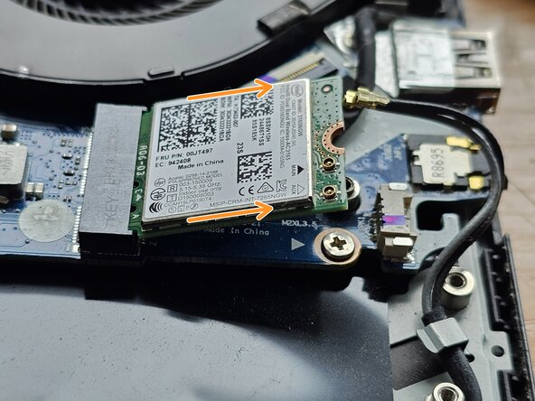

  5. Lenovo Legion Y530-15ICH Upper Case with Keyboard Replacement, Remove the wifi card: crwdns2935265:05crwdnd2935265:01crwdnd2935265:02crwdne2935265:0 Lenovo Legion Y530-15ICH Upper Case with Keyboard Replacement, Remove the wifi card: crwdns2935265:05crwdnd2935265:02crwdnd2935265:02crwdne2935265:0
    • Remove 1 M2.0 x 3.0 mm screw
    • The wifi card will prop up at an angle. Do not panic, this is normal.
    • To remove the wifi card, hold it with two fingers on the sides and pull it in the diagonal direction it is facing when propped up on its own (around 30° by my estimation)

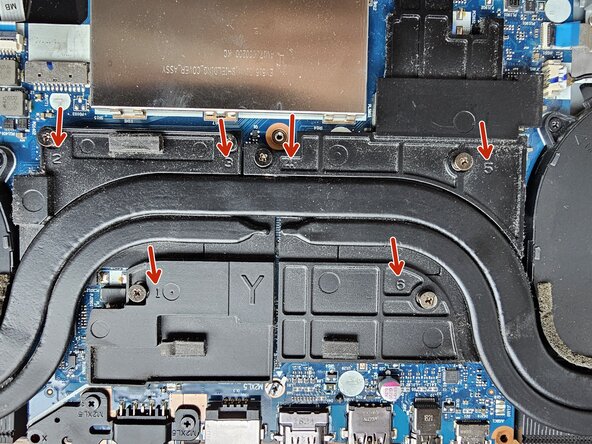

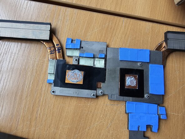

  6. Lenovo Legion Y530-15ICH Upper Case with Keyboard Replacement, Removing the heatsink assembly: crwdns2935265:06crwdnd2935265:01crwdnd2935265:03crwdne2935265:0 Lenovo Legion Y530-15ICH Upper Case with Keyboard Replacement, Removing the heatsink assembly: crwdns2935265:06crwdnd2935265:02crwdnd2935265:03crwdne2935265:0 Lenovo Legion Y530-15ICH Upper Case with Keyboard Replacement, Removing the heatsink assembly: crwdns2935265:06crwdnd2935265:03crwdnd2935265:03crwdne2935265:0
    • The heatsink assembly includes the heatsink through which fans blow, as well as the cooling pipes and copper contact points on the other side (for the CPU and GPU). It does not include the fans (those will be removed in a later step).
    • To start, loosen the 6 screws holding the heatsink pressed down. The numbers don't matter, these are for when you put the heatsink assembly back in.
    • These screws don't come out of their holes, they are meant to stay in.
    • Once you're sure the screws are loosened, lift the heatsink assembly up and away from the laptop by holding it for its furthermost right and left ends. Be careful not to bend or damage anything. Place the heatsink assembly upside down.
    • You will notice the square and rectangle shaped contact points for cooling the GPU and CPU, respectively. They will be smudged by (most likely) old thermal paste. You will also notice these same shapes, smudged with thermal paste on the motherboard itself. These are your GPU and CPU.
    • This would be a good time to perform thermal paste clean up. Use your thermal paste cleaner or >90% isopropyl alcohol together with cotton swabs and cotton balls (or a microfiber cloth) to clean the thermal paste from all 4 surfaces.
    • Don't worry if there is some residue on the sides, thermal paste is made to be non-conductive, so your electrical components are safe.
  7. Lenovo Legion Y530-15ICH Upper Case with Keyboard Replacement, Apply thermal paste (only when reassembling): crwdns2935265:07crwdnd2935265:01crwdnd2935265:02crwdne2935265:0 Lenovo Legion Y530-15ICH Upper Case with Keyboard Replacement, Apply thermal paste (only when reassembling): crwdns2935265:07crwdnd2935265:02crwdnd2935265:02crwdne2935265:0
    • Skip this step if you're disassembling the laptop. Perform this step when you're about to put the heatsink back into the laptop.
    • Apply a small amount (official guide says 0.2g) of thermal paste on each - CPU and GPU cooling contacts. CPU is longer, so apply a line, while applying a dot fits the GPU contact point better.
    • When putting the the heatsink back in, tighten the screws in the order written on the heatsink - from 1 to 6. You cannot overtigthen, as these screws simply stop at their designated torque level.

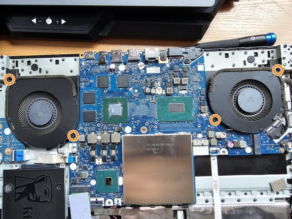

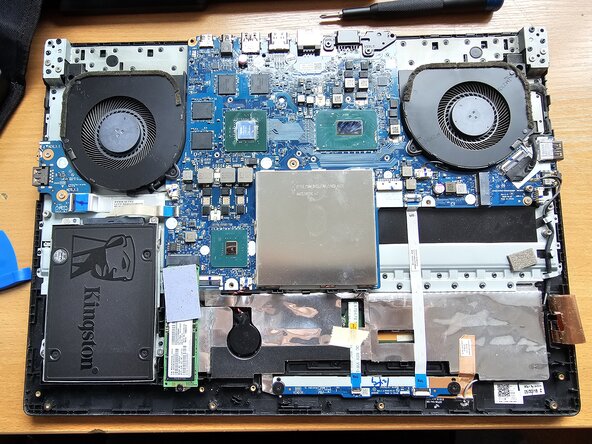

  8. Lenovo Legion Y530-15ICH Upper Case with Keyboard Replacement, Remove the fans: crwdns2935265:08crwdnd2935265:01crwdnd2935265:03crwdne2935265:0 Lenovo Legion Y530-15ICH Upper Case with Keyboard Replacement, Remove the fans: crwdns2935265:08crwdnd2935265:02crwdnd2935265:03crwdne2935265:0 Lenovo Legion Y530-15ICH Upper Case with Keyboard Replacement, Remove the fans: crwdns2935265:08crwdnd2935265:03crwdnd2935265:03crwdne2935265:0
    • Unplug the fan connectors in the direction shown by the arrows. The connectors are similar to the speaker connector, so use the same method here.
    • Remove the 4 M2.0 x 5.0 mm screws
    • Lift the fans up and out of the laptop
    • At this point, you can perform fan and heatsink cleaning by using a paint brush with long bristles and/or compressed air. A soft, large brush will work well here and allow you to perfectly clean your fans. Be careful not to apply too much pressure to the fan blades, however.

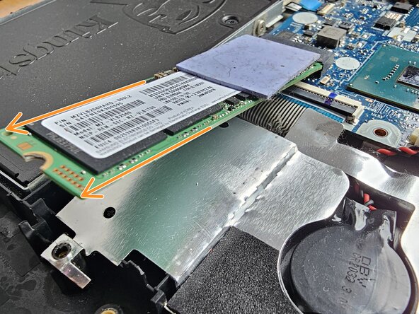

  9. Lenovo Legion Y530-15ICH Upper Case with Keyboard Replacement, Remove the SSD: crwdns2935265:09crwdnd2935265:01crwdnd2935265:02crwdne2935265:0 Lenovo Legion Y530-15ICH Upper Case with Keyboard Replacement, Remove the SSD: crwdns2935265:09crwdnd2935265:02crwdnd2935265:02crwdne2935265:0
    • This is the same as when you removed the wifi card, unfasten the 1 M2.0 x 5.0 mm screw. The SSD will raise and stand at an angle.
    • Remove the SSD by holding it for its sides and lightly pulling in the diagional direction it is pointing at. It should come out easily.
  10. Lenovo Legion Y530-15ICH Upper Case with Keyboard Replacement, Remove the 2.5" SATA disk: crwdns2935265:010crwdnd2935265:01crwdnd2935265:03crwdne2935265:0 Lenovo Legion Y530-15ICH Upper Case with Keyboard Replacement, Remove the 2.5" SATA disk: crwdns2935265:010crwdnd2935265:02crwdnd2935265:03crwdne2935265:0 Lenovo Legion Y530-15ICH Upper Case with Keyboard Replacement, Remove the 2.5" SATA disk: crwdns2935265:010crwdnd2935265:03crwdnd2935265:03crwdne2935265:0
    • This slot usually comes empty, in which case you still must perform this step. The SATA disk holder in your laptop is what you'll be removing then, and the process is the same, save for unplugging the disk from the motherboard.
    • Unplug the motherboard connection to the the SATA disk. You can do this either by unplugging it via the ZIF connector or by removing the SATA connector. My ZIF connector came out on its own when putting the SATA drive back in, so I'd recommend doing that anyway. Lift the little black latch up and to the right (as far as it goes) and then pull the wire out.
    • Unfortunately, I do not have good pictures of me unplugging the wire from this connector. You can find out how to work with ZIF connectors by clicking on the link above, or in the following steps, as there are plenty more of these to be found.
    • Unscrew the 4 M2.0 × 3.5 mm screws and lift the disk up and out of the laptop.

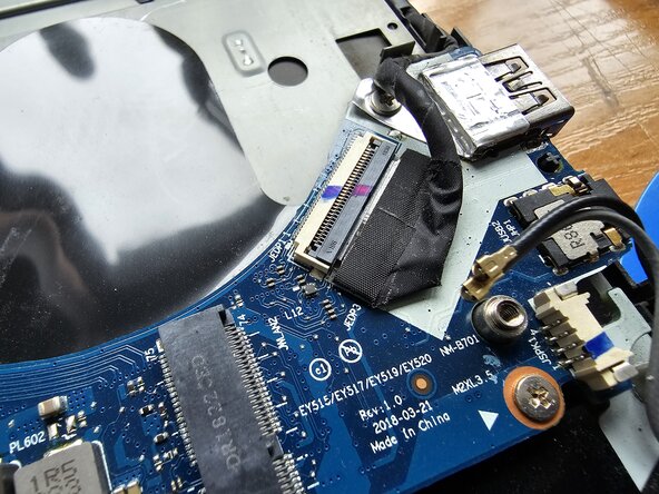

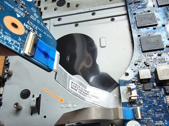

  11. Lenovo Legion Y530-15ICH Upper Case with Keyboard Replacement, Remove the IO board: crwdns2935265:011crwdnd2935265:01crwdnd2935265:02crwdne2935265:0 Lenovo Legion Y530-15ICH Upper Case with Keyboard Replacement, Remove the IO board: crwdns2935265:011crwdnd2935265:02crwdnd2935265:02crwdne2935265:0
    • Unscrew the 2 M2.0 × 3.5 mm screws. Don't mind that I've already taken them amount (whoops, forgot to take a pic before).
    • Unstick the cable from the metal frame.
    • The cable connecting the IO board to the motherboard has some kind of glue connecting a part of it to the metal frame. To remove it, hold the cable (not the IO board) and pull with just enough force to slowly unstick it. Do it carefully.
    • If you want to, you can unplug the ZIF connector connecting the motherboard to the IO board, but it is absolutely not necessary for our purposes.

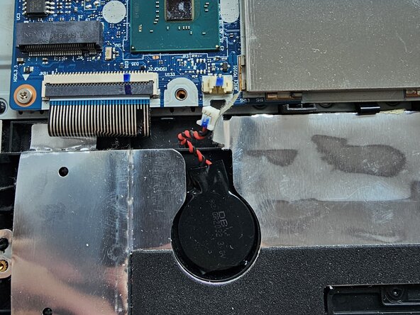

  12. Lenovo Legion Y530-15ICH Upper Case with Keyboard Replacement, Remove the RTC battery: crwdns2935265:012crwdnd2935265:01crwdnd2935265:03crwdne2935265:0 Lenovo Legion Y530-15ICH Upper Case with Keyboard Replacement, Remove the RTC battery: crwdns2935265:012crwdnd2935265:02crwdnd2935265:03crwdne2935265:0 Lenovo Legion Y530-15ICH Upper Case with Keyboard Replacement, Remove the RTC battery: crwdns2935265:012crwdnd2935265:03crwdnd2935265:03crwdne2935265:0
    • This is an important step, as it lowers the risk of any shorts happening while handling the motherboard.
    • The connector for the RTC battery is similar to the speaker and fan connectors. Before removing it, lift the silver flap that's also stuck to a wide cable connected to the motherboard.
    • To unplug the battery, pull on the connector in the direction of the arrows. It is a similar connector to the speaker and fan connectors. In my case, it required a bit more effort to get it out.
    • Finally lift and unstick the battery from it's holder and put it aside.

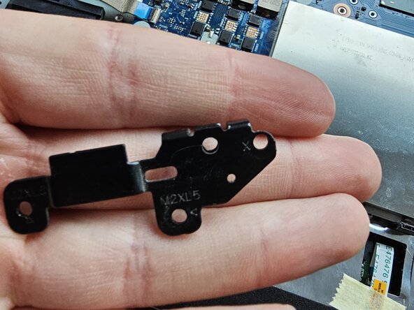

  13. Lenovo Legion Y530-15ICH Upper Case with Keyboard Replacement, Remove the power board bracket: crwdns2935265:013crwdnd2935265:01crwdnd2935265:02crwdne2935265:0 Lenovo Legion Y530-15ICH Upper Case with Keyboard Replacement, Remove the power board bracket: crwdns2935265:013crwdnd2935265:02crwdnd2935265:02crwdne2935265:0
    • Unscrew the 2 M2.0 × 5.0 mm screws and lift the bracket out.

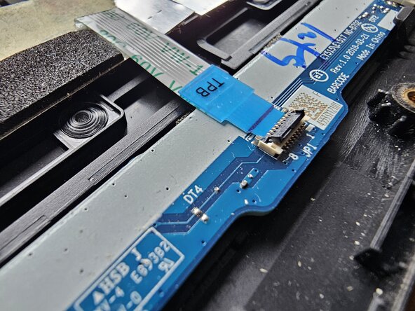

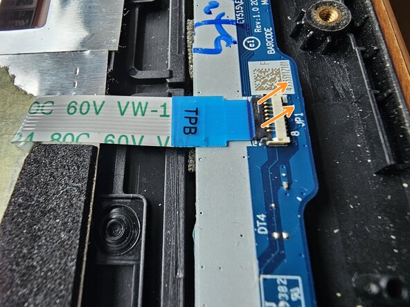

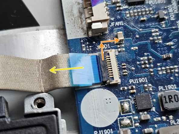

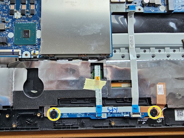

  14. Lenovo Legion Y530-15ICH Upper Case with Keyboard Replacement, Remove the touchpad board (1/2): crwdns2935265:014crwdnd2935265:01crwdnd2935265:03crwdne2935265:0 Lenovo Legion Y530-15ICH Upper Case with Keyboard Replacement, Remove the touchpad board (1/2): crwdns2935265:014crwdnd2935265:02crwdnd2935265:03crwdne2935265:0 Lenovo Legion Y530-15ICH Upper Case with Keyboard Replacement, Remove the touchpad board (1/2): crwdns2935265:014crwdnd2935265:03crwdnd2935265:03crwdne2935265:0
    • First, we must unplug the 2 ZIF connectors.
    • To unplug a ZIF connector, lift the black flap up and away as far as it goes. You can use your nails, an opening tool or anything else.

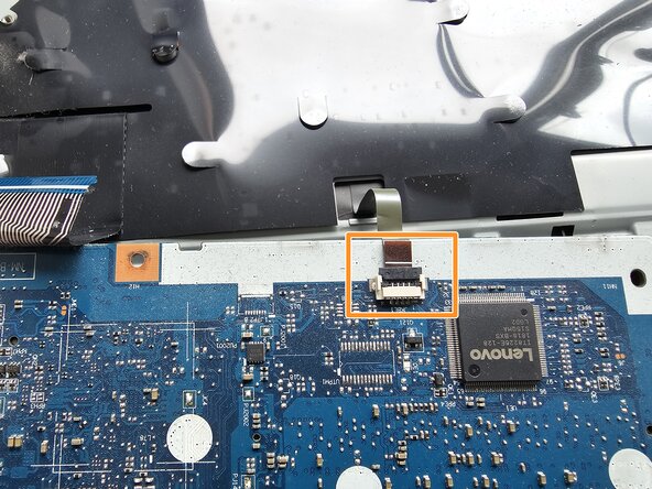

  15. Lenovo Legion Y530-15ICH Upper Case with Keyboard Replacement, Remove the touchpad board (2/2): crwdns2935265:015crwdnd2935265:01crwdnd2935265:03crwdne2935265:0 Lenovo Legion Y530-15ICH Upper Case with Keyboard Replacement, Remove the touchpad board (2/2): crwdns2935265:015crwdnd2935265:02crwdnd2935265:03crwdne2935265:0 Lenovo Legion Y530-15ICH Upper Case with Keyboard Replacement, Remove the touchpad board (2/2): crwdns2935265:015crwdnd2935265:03crwdnd2935265:03crwdne2935265:0
    • Then, use the tweezers or your fingers to gently pull the cable out. Grab the blue strip, as it is intended to be a helping tool when plugging and unplugging these cables. It should have no resistance.
    • Repeat the process with the other cable, but this time on the motherboard instead of the touchpad board. This one didn't have a big enough blue strip to grab with my tweezers, but it was easy enough to pull out without needing them.
    • When plugging ZIF connectors back in, push them in all the way and close the flap back down. Usually, there is a line indicating where the latch should rest while closed. Also keep in mind that in some cases, this line is just in front of the closed latch, and sometimes covered by it.
    • Finally, unscrew the 2 wide M2.0 × 3.0 mm screws and lift the touchpad board, along with one cable, out of the laptop.

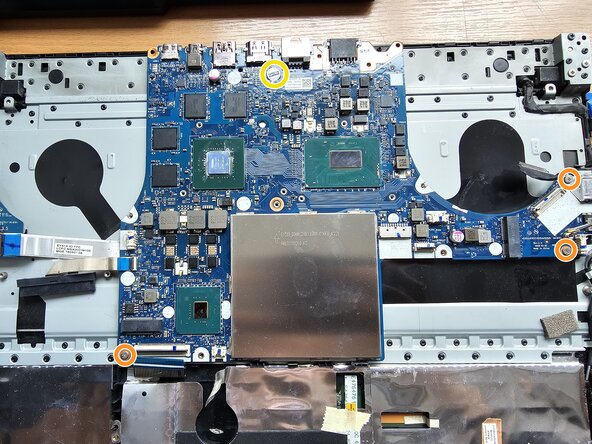

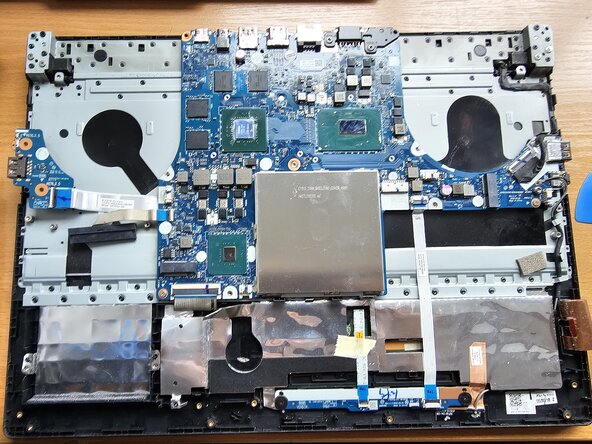

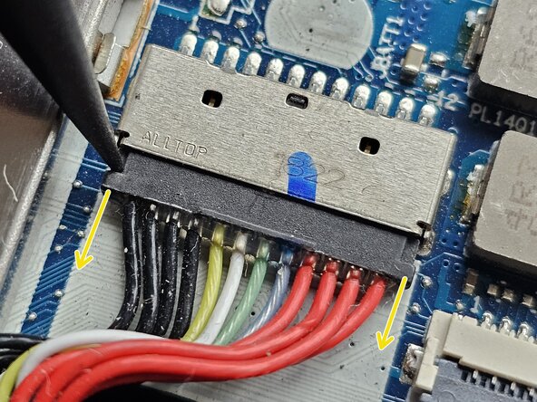

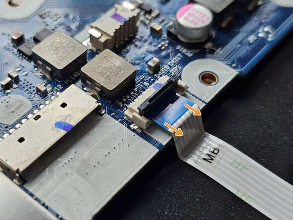

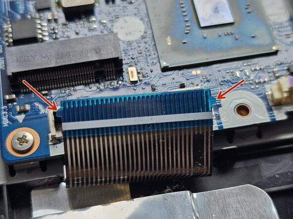

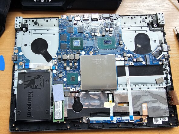

  16. Lenovo Legion Y530-15ICH Upper Case with Keyboard Replacement, Remove the system board (motherboard) (1/3): crwdns2935265:016crwdnd2935265:01crwdnd2935265:03crwdne2935265:0 Lenovo Legion Y530-15ICH Upper Case with Keyboard Replacement, Remove the system board (motherboard) (1/3): crwdns2935265:016crwdnd2935265:02crwdnd2935265:03crwdne2935265:0 Lenovo Legion Y530-15ICH Upper Case with Keyboard Replacement, Remove the system board (motherboard) (1/3): crwdns2935265:016crwdnd2935265:03crwdnd2935265:03crwdne2935265:0
    • This is the trickiest part in this whole guide. Be careful not to damage or tear any cables or wires, or damage any components.
    • Detach the 2 ZIF connectors in the bottom left and right side of the motherboard. They are wider than others so they're easy to spot.
    • The connectors have flaps on the sides! I didn't know this at first and was confused why they didn't want to come out easily. You must lift them up and then out to detach them. When putting them back in, make sure the side flaps are securely inside of the connector.

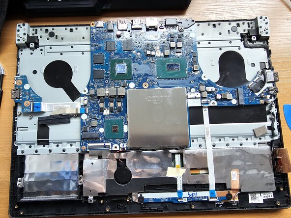

  17. Lenovo Legion Y530-15ICH Upper Case with Keyboard Replacement, Remove the system board (motherboard) (2/3): crwdns2935265:017crwdnd2935265:01crwdnd2935265:03crwdne2935265:0 Lenovo Legion Y530-15ICH Upper Case with Keyboard Replacement, Remove the system board (motherboard) (2/3): crwdns2935265:017crwdnd2935265:02crwdnd2935265:03crwdne2935265:0 Lenovo Legion Y530-15ICH Upper Case with Keyboard Replacement, Remove the system board (motherboard) (2/3): crwdns2935265:017crwdnd2935265:03crwdnd2935265:03crwdne2935265:0
    • After deatching the connectors, unscrew the 3 M2.0 × 3.5 mm screws.

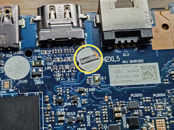

    • Unscrew 1 M2.0 × 5.0 mm screw, hidden behind a Lenovo sticker near the top of the board.
  18. Lenovo Legion Y530-15ICH Upper Case with Keyboard Replacement, Remove the system board (motherboard) (3/3): crwdns2935265:018crwdnd2935265:01crwdnd2935265:03crwdne2935265:0 Lenovo Legion Y530-15ICH Upper Case with Keyboard Replacement, Remove the system board (motherboard) (3/3): crwdns2935265:018crwdnd2935265:02crwdnd2935265:03crwdne2935265:0 Lenovo Legion Y530-15ICH Upper Case with Keyboard Replacement, Remove the system board (motherboard) (3/3): crwdns2935265:018crwdnd2935265:03crwdnd2935265:03crwdne2935265:0

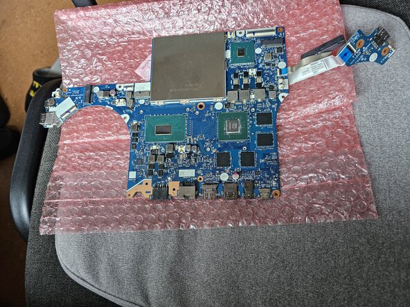

    • Flip the board over by lifting the part of the board furthest away from you and placing it on the laptop slowly so that you can see its underside. You will notice a cable which you must unplug. You can see what this looks like on the screenshot from the manual.
    • Once you've unplugged the connector, remove the entire board from the laptop.

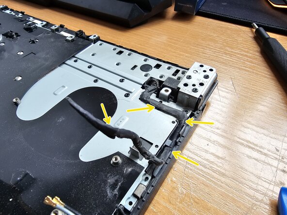

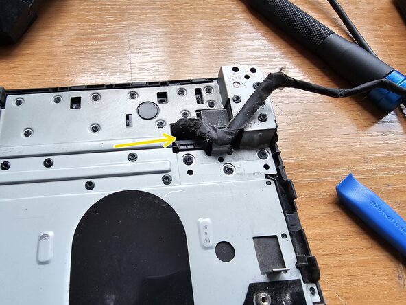

  19. Lenovo Legion Y530-15ICH Upper Case with Keyboard Replacement, Unscrew the hinge and free the cable: crwdns2935265:019crwdnd2935265:01crwdnd2935265:03crwdne2935265:0 Lenovo Legion Y530-15ICH Upper Case with Keyboard Replacement, Unscrew the hinge and free the cable: crwdns2935265:019crwdnd2935265:02crwdnd2935265:03crwdne2935265:0 Lenovo Legion Y530-15ICH Upper Case with Keyboard Replacement, Unscrew the hinge and free the cable: crwdns2935265:019crwdnd2935265:03crwdnd2935265:03crwdne2935265:0
    • Remove 1 M2.5 × 7 mm black-coloured screw from one of the hinges.
    • Remove 2 M2.0 × 2.3 mm silver-coloured screws.
    • Repeat this process for the other hinge.
    • Free the black cable you disconnected earlier on the right side. It has a little bit of glue on one of its parts. This cable will come out through the hole that you can see.

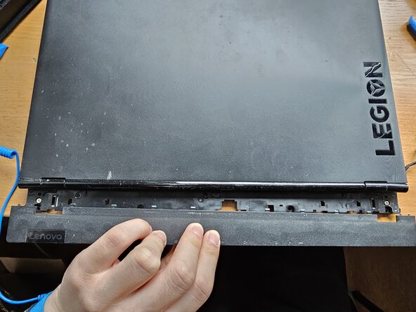

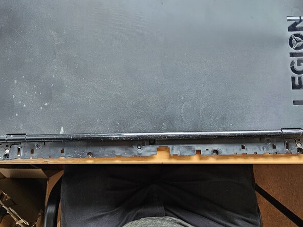

  20. Lenovo Legion Y530-15ICH Upper Case with Keyboard Replacement, Remove the hinge cap: crwdns2935265:020crwdnd2935265:01crwdnd2935265:03crwdne2935265:0 Lenovo Legion Y530-15ICH Upper Case with Keyboard Replacement, Remove the hinge cap: crwdns2935265:020crwdnd2935265:02crwdnd2935265:03crwdne2935265:0 Lenovo Legion Y530-15ICH Upper Case with Keyboard Replacement, Remove the hinge cap: crwdns2935265:020crwdnd2935265:03crwdnd2935265:03crwdne2935265:0
    • Flip the laptop the same way you flipped the motherboard earlier, being careful not to damage the cable you freed.
    • Pull the hinge cap up and then towards yourself diagonally to remove it. It should be easy.

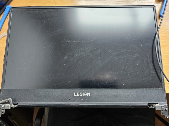

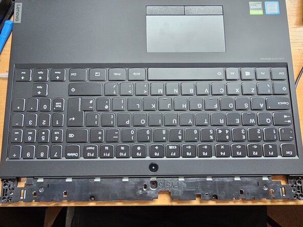

  21. Lenovo Legion Y530-15ICH Upper Case with Keyboard Replacement, Remove the display: crwdns2935265:021crwdnd2935265:01crwdnd2935265:03crwdne2935265:0 Lenovo Legion Y530-15ICH Upper Case with Keyboard Replacement, Remove the display: crwdns2935265:021crwdnd2935265:02crwdnd2935265:03crwdne2935265:0 Lenovo Legion Y530-15ICH Upper Case with Keyboard Replacement, Remove the display: crwdns2935265:021crwdnd2935265:03crwdnd2935265:03crwdne2935265:0
    • Pull the display up, being careful to route the black cable through the hole and then set it aside.
    • Congratulations!!! You successfully reached the end of this guide! Now it's up to you to take the new upper case unit and redo all these steps in reverse order. Be careful, as some things are a bit different, such as plugging the cables in instead of unplugging and applying thermal paste.
    • It was way less stressful for me putting things back together. I knew everything I've done so far so there was no unknown territory. Good luck and thank you for following my guide. :)
