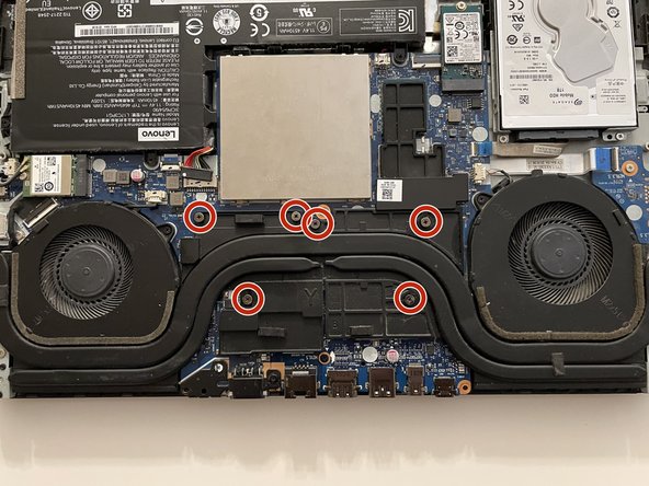

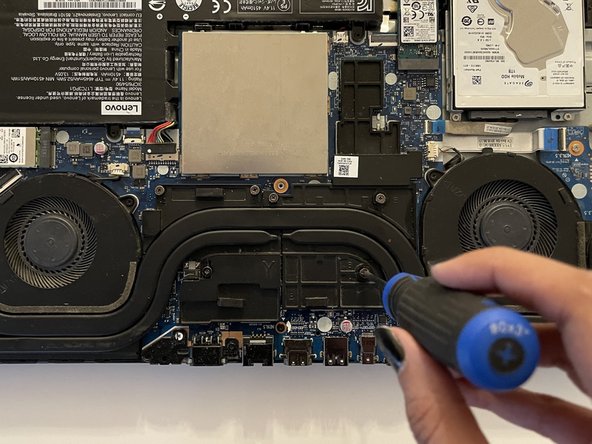

    • Loosen the 6 spring screws with a Phillips #1 screwdriver.
    • The spring screws will not fully detach from the heatsink; continue loosening until you hear a "click" noise.
    • Gently lift up the heatsink and set it aside.

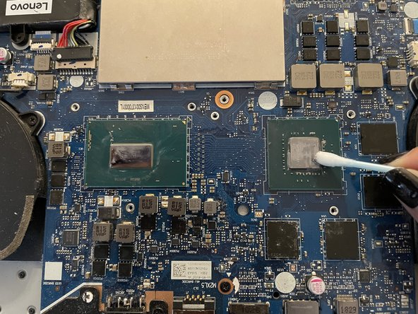

    • Clean the bulk of the old thermal paste with a tissue dipped in high-concentration isopropyl alcohol.
    • Clean the remaining old thermal paste stuck in the crevices with cotton swabs dipped in high-concentration isopropyl alcohol.
  5. Lenovo Legion Y530-15ICH Thermal Paste Replacement: crwdns2935265:05crwdnd2935265:01crwdnd2935265:01crwdne2935265:0
    • Clean the backside of the heatsink with cotton swabs dipped in high-concentrate isopropyl alcohol.
