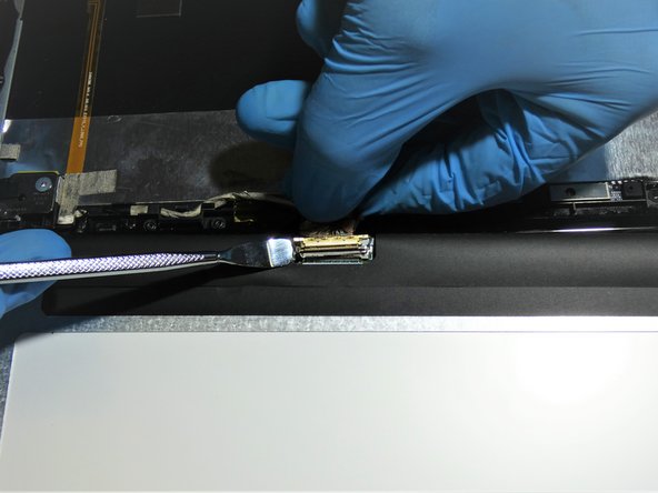

    • Carefully insert the plastic opening tool behind the screen to remove the adhesive.
  4. Lenovo Legion Y530-15ICH Screen Replacement: crwdns2935265:04crwdnd2935265:01crwdnd2935265:03crwdne2935265:0 Lenovo Legion Y530-15ICH Screen Replacement: crwdns2935265:04crwdnd2935265:02crwdnd2935265:03crwdne2935265:0 Lenovo Legion Y530-15ICH Screen Replacement: crwdns2935265:04crwdnd2935265:03crwdnd2935265:03crwdne2935265:0
    • Using a small metal spudger, disconnet the LCD connector.
    • Carefully remove the screen from the device.
