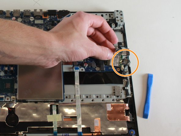

  15. Lenovo Legion Y530-15ICH Motherboard Replacement: crwdns2935265:015crwdnd2935265:01crwdnd2935265:01crwdne2935265:0
    • Remove two ribbon cables in the circled areas. Gently pull them out of their ports.
  16. Lenovo Legion Y530-15ICH Motherboard Replacement: crwdns2935265:016crwdnd2935265:01crwdnd2935265:01crwdne2935265:0
    • Remove the final ribbon cable by gently pulling it from its socket.
    • The motherboard is now completely disconnected from the laptop.
