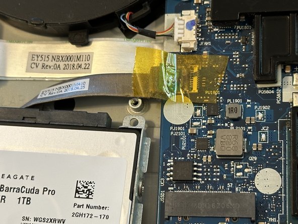

    • You might see a yellow piece of tape here. Peel it off carefully, right to left in this orientation, so that the blue plastic of the ribbon cable beneath is unmoved when it's gone.
  4. Lenovo Legion Y530-15ICH Hard Drive Replacement: crwdns2935265:04crwdnd2935265:01crwdnd2935265:02crwdne2935265:0 Lenovo Legion Y530-15ICH Hard Drive Replacement: crwdns2935265:04crwdnd2935265:02crwdnd2935265:02crwdne2935265:0
    • Use your prying tool or a spudger to flip up the FFC bail, the tiny black clamp shown here.
    • If the cable doesn't move freely after the bail is up, make sure it's pushed all the way back, and lightly tug the cable away from its clamp.
    • Pull only parallel to the board, and only after the bail is up.

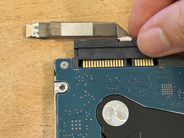

  7. Lenovo Legion Y530-15ICH Hard Drive Replacement: crwdns2935265:07crwdnd2935265:01crwdnd2935265:02crwdne2935265:0 Lenovo Legion Y530-15ICH Hard Drive Replacement: crwdns2935265:07crwdnd2935265:02crwdnd2935265:02crwdne2935265:0
    • This piece connects your hard drive to the computer. Remove it carefully, wiggling back and forth. Replace it on your new hard drive.
Once the ribbon cable piece has been attached to the new hard drive, just follow these steps in the reverse order.
