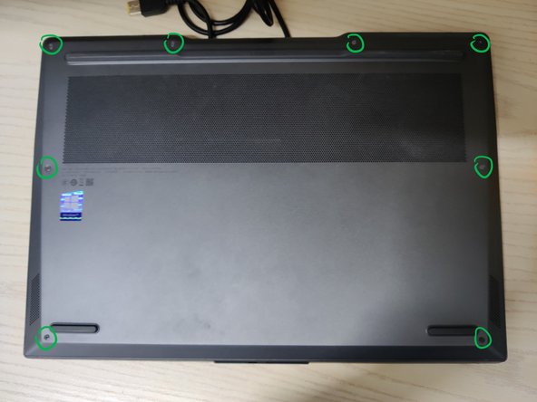

  1. Lenovo Legion Slim 7 2021 Battery Replacement, Remove back cover screws: crwdns2935265:01crwdnd2935265:01crwdnd2935265:01crwdne2935265:0
    • Flip the laptop.
    • Remove the 8 screws on the back cover and keep them safe.

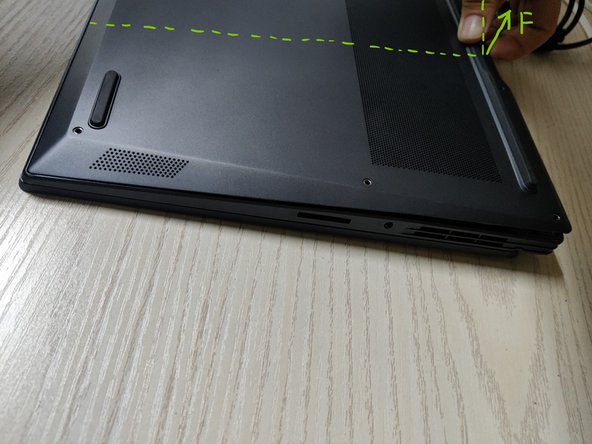

  3. Lenovo Legion Slim 7 2021 Battery Replacement, Open the back cover: crwdns2935265:03crwdnd2935265:01crwdnd2935265:03crwdne2935265:0 Lenovo Legion Slim 7 2021 Battery Replacement, Open the back cover: crwdns2935265:03crwdnd2935265:02crwdnd2935265:03crwdne2935265:0 Lenovo Legion Slim 7 2021 Battery Replacement, Open the back cover: crwdns2935265:03crwdnd2935265:03crwdnd2935265:03crwdne2935265:0
    • Use your finger to lift the rear side of the back cover up.
    • Add force backwards and upwards until the back cover is open.
    • Do not add a lot of force. If it is hard to open, try adjusting the direction of the force.

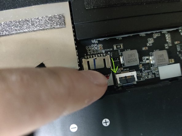

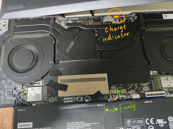

  4. Lenovo Legion Slim 7 2021 Battery Replacement, Disconnect battery: crwdns2935265:04crwdnd2935265:01crwdnd2935265:02crwdne2935265:0 Lenovo Legion Slim 7 2021 Battery Replacement, Disconnect battery: crwdns2935265:04crwdnd2935265:02crwdnd2935265:02crwdne2935265:0
    • Pry the battery cable out by a little bit to disconnect the battery from the board.
    • Avoid using sharp or metallic spudgers, as they may slip and damage the device.

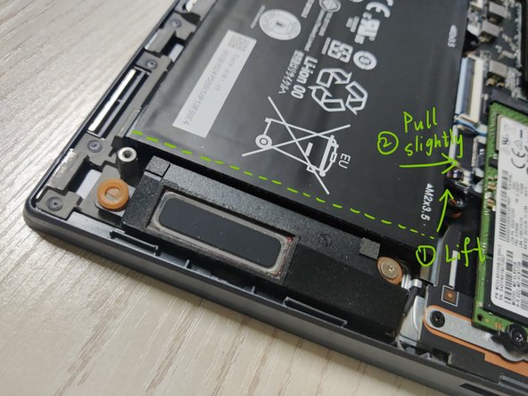

  5. Lenovo Legion Slim 7 2021 Battery Replacement, Remove battery: crwdns2935265:05crwdnd2935265:01crwdnd2935265:03crwdne2935265:0 Lenovo Legion Slim 7 2021 Battery Replacement, Remove battery: crwdns2935265:05crwdnd2935265:02crwdnd2935265:03crwdne2935265:0 Lenovo Legion Slim 7 2021 Battery Replacement, Remove battery: crwdns2935265:05crwdnd2935265:03crwdnd2935265:03crwdne2935265:0
    • Remove the 4 screws on the battery.
    • Lift the inner side of the battery up, and pull it inwards slightly.
    • Take the battery cable out completely and remove the battery.

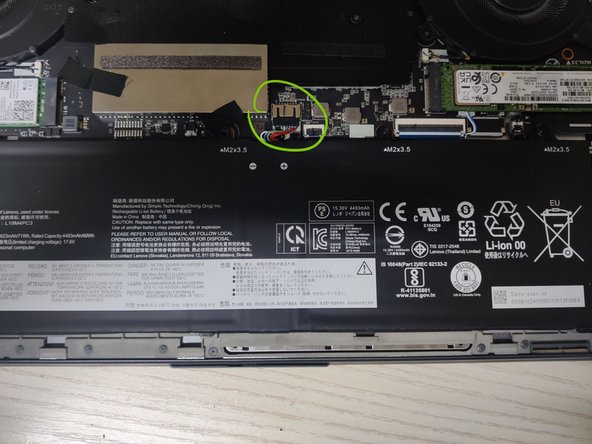

  6. Lenovo Legion Slim 7 2021 Battery Replacement, Install new battery: crwdns2935265:06crwdnd2935265:01crwdnd2935265:03crwdne2935265:0 Lenovo Legion Slim 7 2021 Battery Replacement, Install new battery: crwdns2935265:06crwdnd2935265:02crwdnd2935265:03crwdne2935265:0 Lenovo Legion Slim 7 2021 Battery Replacement, Install new battery: crwdns2935265:06crwdnd2935265:03crwdnd2935265:03crwdne2935265:0
    • Align the new battery and its cable into place.
    • Push the battery cable into the socket firmly. You will notice the charge indicator LED flash red when it is connected.
    • Add the 4 screws back.

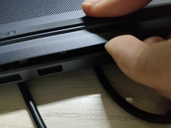

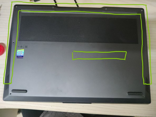

  7. Lenovo Legion Slim 7 2021 Battery Replacement, Align back cover: crwdns2935265:07crwdnd2935265:01crwdnd2935265:03crwdne2935265:0 Lenovo Legion Slim 7 2021 Battery Replacement, Align back cover: crwdns2935265:07crwdnd2935265:02crwdnd2935265:03crwdne2935265:0 Lenovo Legion Slim 7 2021 Battery Replacement, Align back cover: crwdns2935265:07crwdnd2935265:03crwdnd2935265:03crwdne2935265:0
    • Carefully align the front side of the back cover into place.
    • Press the back cover down. Then push the marked areas to get the plastic clips back into place.

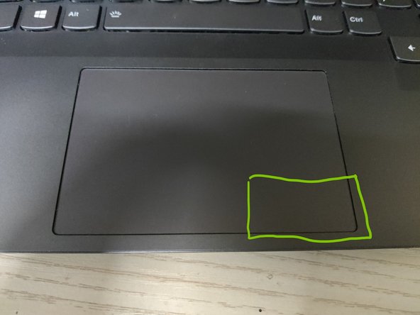

    • Turn the laptop over to make sure the trackpad aligns well. If it pops out as if the new battery got swollen again, try taking off the back cover and reinstall it.
