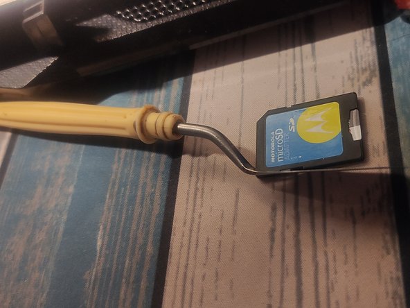

  3. Lenovo Legion 7i screen Replacement, Bezel Removal Prerequisite. Spatula: crwdns2935265:03crwdnd2935265:01crwdnd2935265:02crwdne2935265:0 Lenovo Legion 7i screen Replacement, Bezel Removal Prerequisite. Spatula: crwdns2935265:03crwdnd2935265:02crwdnd2935265:02crwdne2935265:0
    • Removing the bezel you may need some type of very thin slim spatual like tool. Similiar to ones used in 3d printing to remove prints from the printing bed.
    • You will be cutting a slight adhesive throught the insides of the bezel.
