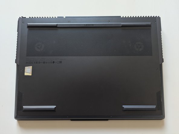

  2. Lenovo Legion 7 16ACHg6 Thermal Paste Replacement, Back Cover Removal: crwdns2935265:02crwdnd2935265:01crwdnd2935265:02crwdne2935265:0 Lenovo Legion 7 16ACHg6 Thermal Paste Replacement, Back Cover Removal: crwdns2935265:02crwdnd2935265:02crwdnd2935265:02crwdne2935265:0
    • Use a Philips screwdriver to remove the following ten screws that secures the back cover of the laptop.
  3. Lenovo Legion 7 16ACHg6 Thermal Paste Replacement, Remove the Back Cover: crwdns2935265:03crwdnd2935265:01crwdnd2935265:01crwdne2935265:0
    • Use an opening pick to carefully remove the back cover from the frame of the laptop by placing the pick between the cover and the frame. Work around the frame, paying extra attention to the vent clips on the side of the laptop. Lift cover and remove it from the chassis.

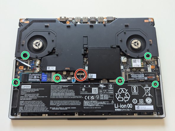

  4. Lenovo Legion 7 16ACHg6 Thermal Paste Replacement, Detach the Battery Cable and the Two SSD Cover Plates: crwdns2935265:04crwdnd2935265:01crwdnd2935265:02crwdne2935265:0 Lenovo Legion 7 16ACHg6 Thermal Paste Replacement, Detach the Battery Cable and the Two SSD Cover Plates: crwdns2935265:04crwdnd2935265:02crwdnd2935265:02crwdne2935265:0
    • Carefully detach the battery connecter from the motherboard.
    • Remove the six screw securing the two SSD cover plates with a Philips screwdriver.

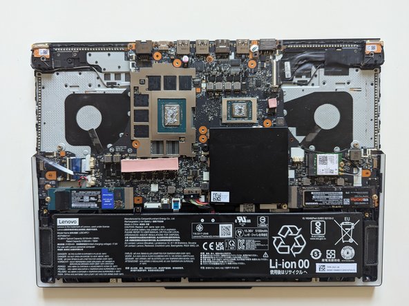

  5. Lenovo Legion 7 16ACHg6 Thermal Paste Replacement, Locate and Unscrew the CPU and GPU Heatsink: crwdns2935265:05crwdnd2935265:01crwdnd2935265:01crwdne2935265:0
    • Find the CPU and GPU on the motherboard, covered by a heatsink. Unscrew the ten screws with a Philips screw driver.

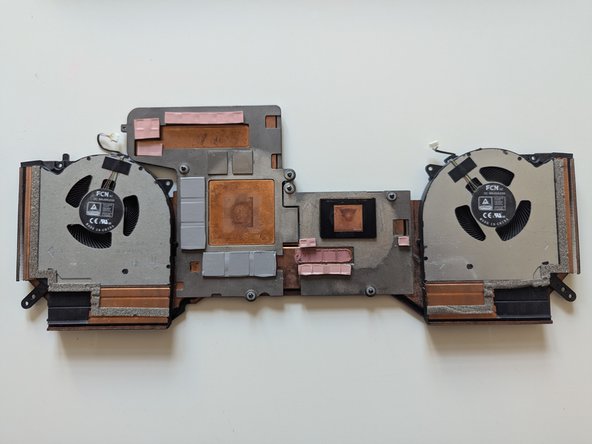

  7. Lenovo Legion 7 16ACHg6 Thermal Paste Replacement, Remove Heatsink: crwdns2935265:07crwdnd2935265:01crwdnd2935265:01crwdne2935265:0
    • Carefully remove the heatsink, ensuring not to damage the CPU and GPU.

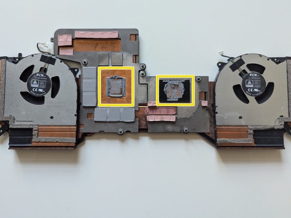

  8. Lenovo Legion 7 16ACHg6 Thermal Paste Replacement, Clean Old Thermal Paste: crwdns2935265:08crwdnd2935265:01crwdnd2935265:03crwdne2935265:0 Lenovo Legion 7 16ACHg6 Thermal Paste Replacement, Clean Old Thermal Paste: crwdns2935265:08crwdnd2935265:02crwdnd2935265:03crwdne2935265:0 Lenovo Legion 7 16ACHg6 Thermal Paste Replacement, Clean Old Thermal Paste: crwdns2935265:08crwdnd2935265:03crwdnd2935265:03crwdne2935265:0
    • Use a clean cloth or cotton swab with isopropyl alcohol to thoroughly clean off the old thermal paste from the CPU, GPU and heatsink.
