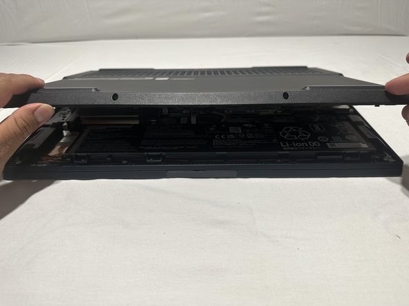

  5. Lenovo Legion 5 17ACH6H RAM Replacement: crwdns2935265:05crwdnd2935265:01crwdnd2935265:03crwdne2935265:0 Lenovo Legion 5 17ACH6H RAM Replacement: crwdns2935265:05crwdnd2935265:02crwdnd2935265:03crwdne2935265:0 Lenovo Legion 5 17ACH6H RAM Replacement: crwdns2935265:05crwdnd2935265:03crwdnd2935265:03crwdne2935265:0

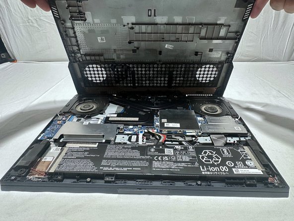

    • Grab the back panel and lift it to remove it from the chassis.
    • Before completely lifting the back panel, the panel should be pushed a little bit away from you. This is to prevent the panel from getting stuck with the IO ports.

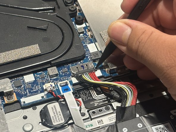

  6. Lenovo Legion 5 17ACH6H RAM Replacement: crwdns2935265:06crwdnd2935265:01crwdnd2935265:03crwdne2935265:0 Lenovo Legion 5 17ACH6H RAM Replacement: crwdns2935265:06crwdnd2935265:02crwdnd2935265:03crwdne2935265:0 Lenovo Legion 5 17ACH6H RAM Replacement: crwdns2935265:06crwdnd2935265:03crwdnd2935265:03crwdne2935265:0

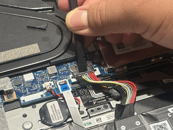

    • Use the pointed tip of a spudger to carefully push on each side of the connector.
    • Use the flat side of the spudger at the top of the battery connector to completely push it out.
    • Pull the cable by the connector and not the wires to move it out of the way.
    • It is important to disconnect the battery since touching the components with the battery connected can short-circuit the device. This could cause damage to the components and yourself.

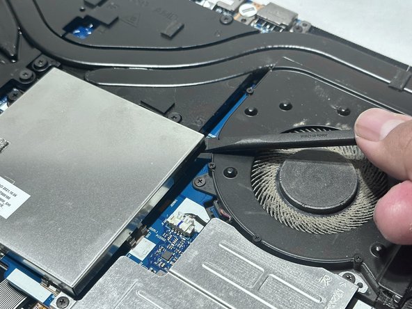

  8. Lenovo Legion 5 17ACH6H RAM Replacement: crwdns2935265:08crwdnd2935265:01crwdnd2935265:03crwdne2935265:0 Lenovo Legion 5 17ACH6H RAM Replacement: crwdns2935265:08crwdnd2935265:02crwdnd2935265:03crwdne2935265:0 Lenovo Legion 5 17ACH6H RAM Replacement: crwdns2935265:08crwdnd2935265:03crwdnd2935265:03crwdne2935265:0

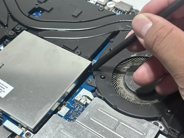

    • Place the flat side of the spudger between the fan (right) and the metal plate (left).
    • Pry open the top part of the metal plate by moving the spudger toward the fan.
  9. Lenovo Legion 5 17ACH6H RAM Replacement: crwdns2935265:09crwdnd2935265:01crwdnd2935265:03crwdne2935265:0 Lenovo Legion 5 17ACH6H RAM Replacement: crwdns2935265:09crwdnd2935265:02crwdnd2935265:03crwdne2935265:0 Lenovo Legion 5 17ACH6H RAM Replacement: crwdns2935265:09crwdnd2935265:03crwdnd2935265:03crwdne2935265:0
    • Grab both sides of the metal plate to lift it off the clips.

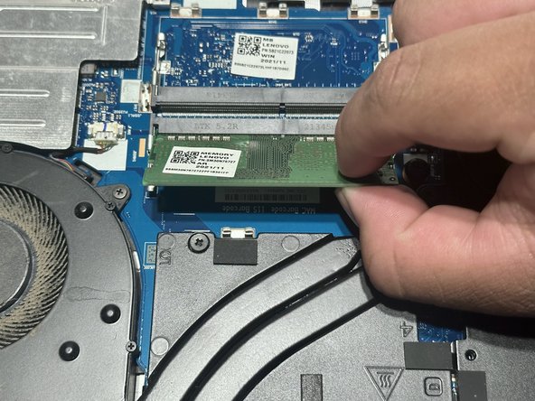

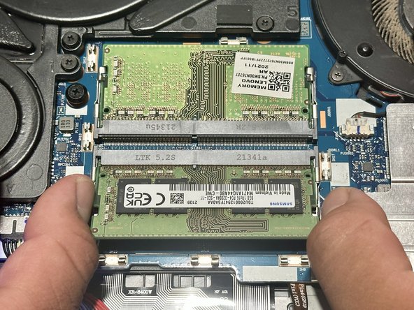

    • With both thumbs, push the clips outward.
    • Gently slide the RAM module out of the socket to remove it.
  11. Lenovo Legion 5 17ACH6H RAM Replacement: crwdns2935265:011crwdnd2935265:01crwdnd2935265:03crwdne2935265:0 Lenovo Legion 5 17ACH6H RAM Replacement: crwdns2935265:011crwdnd2935265:02crwdnd2935265:03crwdne2935265:0 Lenovo Legion 5 17ACH6H RAM Replacement: crwdns2935265:011crwdnd2935265:03crwdnd2935265:03crwdne2935265:0
    • Repeat step 10 to remove the top module.
    • The laptop was rotated 180 degrees, which is why it is facing the camera.

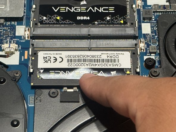

  12. Lenovo Legion 5 17ACH6H RAM Replacement: crwdns2935265:012crwdnd2935265:01crwdnd2935265:03crwdne2935265:0 Lenovo Legion 5 17ACH6H RAM Replacement: crwdns2935265:012crwdnd2935265:02crwdnd2935265:03crwdne2935265:0 Lenovo Legion 5 17ACH6H RAM Replacement: crwdns2935265:012crwdnd2935265:03crwdnd2935265:03crwdne2935265:0

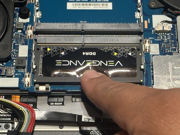

    • Insert the RAM module at a 45-degree angle.
    • Make sure the module aligns with the slot. You can check by making sure the module pins' holes align with the slot.
    • With a finger on the top part of the module, push the RAM stick downward.
    • A click indicates that the module has been inserted successfully.

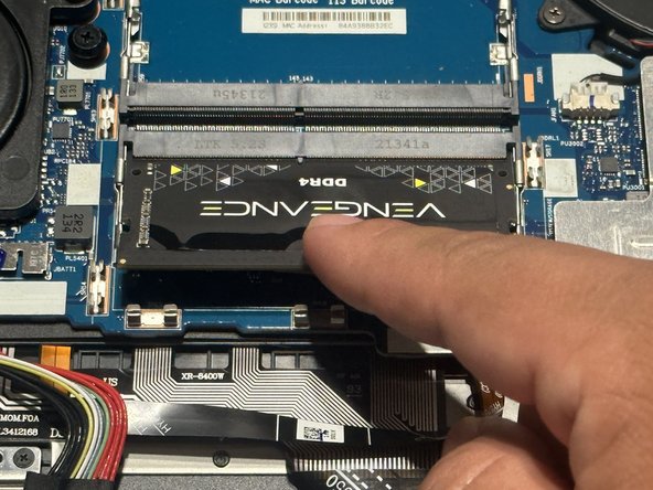

  13. Lenovo Legion 5 17ACH6H RAM Replacement: crwdns2935265:013crwdnd2935265:01crwdnd2935265:03crwdne2935265:0 Lenovo Legion 5 17ACH6H RAM Replacement: crwdns2935265:013crwdnd2935265:02crwdnd2935265:03crwdne2935265:0 Lenovo Legion 5 17ACH6H RAM Replacement: crwdns2935265:013crwdnd2935265:03crwdnd2935265:03crwdne2935265:0
    • Repeat step 12 to insert the top RAM module.
