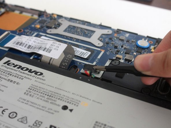

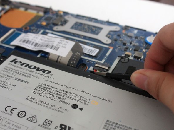

    • Locate the cable connecting to the battery. It is located at the top-center of the battery.
    • Use a pair of tweezers and place it so that the tweezer is around the cables. Gently pull the cables towards the battery to disconnect the cable.

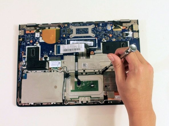

    • Unscrew 7x 2mm screws holding touchpad in place.
