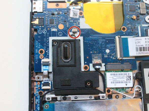

    • Locate the connecting cables.
  6. Lenovo Ideapad Yoga 2 11 Speakers Replacement: crwdns2935265:06crwdnd2935265:01crwdnd2935265:02crwdne2935265:0 Lenovo Ideapad Yoga 2 11 Speakers Replacement: crwdns2935265:06crwdnd2935265:02crwdnd2935265:02crwdne2935265:0
    • Unclip the cables by pulling downwards gently using tweezers.
  7. Lenovo Ideapad Yoga 2 11 Speakers Replacement: crwdns2935265:07crwdnd2935265:01crwdnd2935265:01crwdne2935265:0
    • After the cables are disconnected, remove the speakers by lifting the speakers up.
