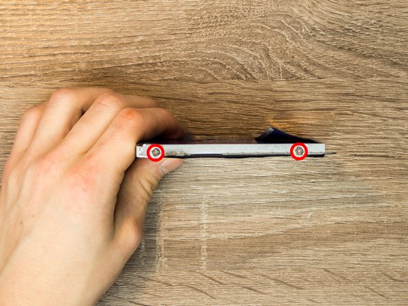

  4. Lenovo Ideapad Y700 15-ISK Hard Drive Replacement, Removing the bracket.: crwdns2935265:04crwdnd2935265:01crwdnd2935265:03crwdne2935265:0 Lenovo Ideapad Y700 15-ISK Hard Drive Replacement, Removing the bracket.: crwdns2935265:04crwdnd2935265:02crwdnd2935265:03crwdne2935265:0 Lenovo Ideapad Y700 15-ISK Hard Drive Replacement, Removing the bracket.: crwdns2935265:04crwdnd2935265:03crwdnd2935265:03crwdne2935265:0
    • Unplug the SATA adaptor from the disk.
    • Remove these 4 screws with a phillips screwdriver.
    • Remove the disk from the bracket.
The drive is out. To install a new one, just follow the steps in the opposite order.
