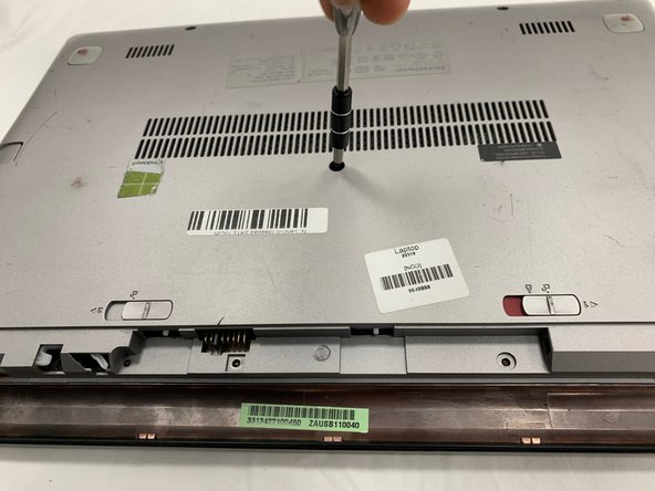

  6. Lenovo Ideapad S415 Touch RAM Replacement, RAM: crwdns2935265:06crwdnd2935265:01crwdnd2935265:02crwdne2935265:0 Lenovo Ideapad S415 Touch RAM Replacement, RAM: crwdns2935265:06crwdnd2935265:02crwdnd2935265:02crwdne2935265:0
    • Locate the five 6mm black screws on the bottom.
    • Using a Phillips #0 screwdriver, remove all five screws.

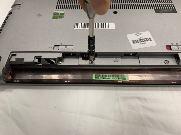

  7. Lenovo Ideapad S415 Touch RAM Replacement: crwdns2935265:07crwdnd2935265:01crwdnd2935265:02crwdne2935265:0 Lenovo Ideapad S415 Touch RAM Replacement: crwdns2935265:07crwdnd2935265:02crwdnd2935265:02crwdne2935265:0
    • Locate the three 4mm silver screws on the bottom area where the battery was removed.
    • Use the Phillips #0 screwdriver to remove all three screws.

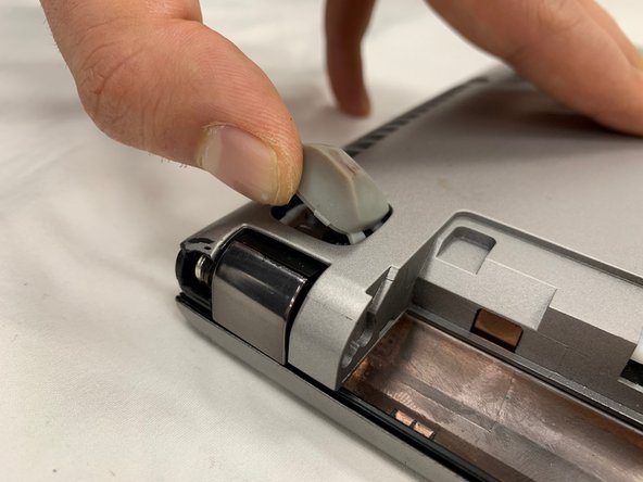

  8. Lenovo Ideapad S415 Touch RAM Replacement: crwdns2935265:08crwdnd2935265:01crwdnd2935265:03crwdne2935265:0 Lenovo Ideapad S415 Touch RAM Replacement: crwdns2935265:08crwdnd2935265:02crwdnd2935265:03crwdne2935265:0 Lenovo Ideapad S415 Touch RAM Replacement: crwdns2935265:08crwdnd2935265:03crwdnd2935265:03crwdne2935265:0
    • Locate the four rubber stoppers near each corner of the laptop.
    • Open up the stoppers by lifting each with your hands.
  9. Lenovo Ideapad S415 Touch RAM Replacement: crwdns2935265:09crwdnd2935265:01crwdnd2935265:03crwdne2935265:0 Lenovo Ideapad S415 Touch RAM Replacement: crwdns2935265:09crwdnd2935265:02crwdnd2935265:03crwdne2935265:0 Lenovo Ideapad S415 Touch RAM Replacement: crwdns2935265:09crwdnd2935265:03crwdnd2935265:03crwdne2935265:0
    • Under each of the four stoppers, there will be a 6mm screw.
    • Use the Phillips #0 screwdriver to remove all four screws.

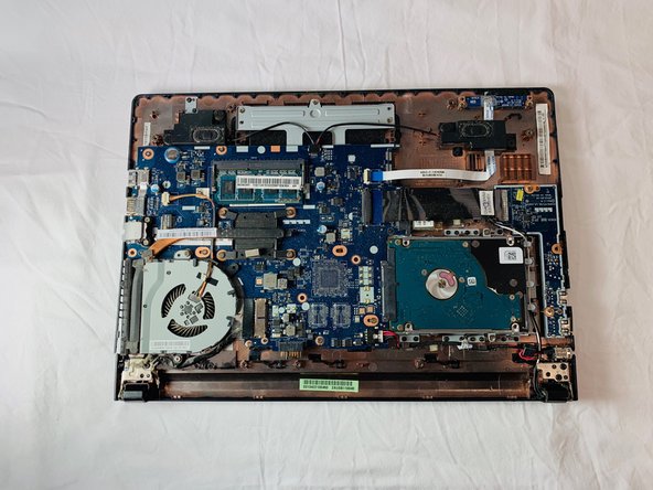

  10. Lenovo Ideapad S415 Touch RAM Replacement: crwdns2935265:010crwdnd2935265:01crwdnd2935265:02crwdne2935265:0 Lenovo Ideapad S415 Touch RAM Replacement: crwdns2935265:010crwdnd2935265:02crwdnd2935265:02crwdne2935265:0
    • Carefully open up the laptop to reveal the internal components.

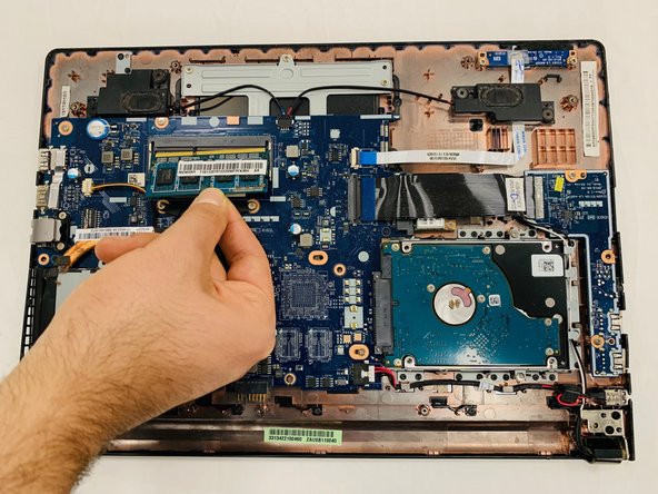

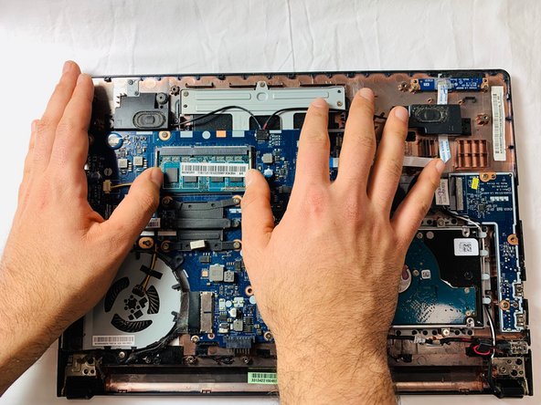

    • Locate the RAM.
    • Using your hands gently push up on the two silver clips located on both ends of the RAM.
    • The RAM will spring out. Gently pull it out of the slot.
    • Do not touch the top yellow part of the RAM as this will cause damage.
