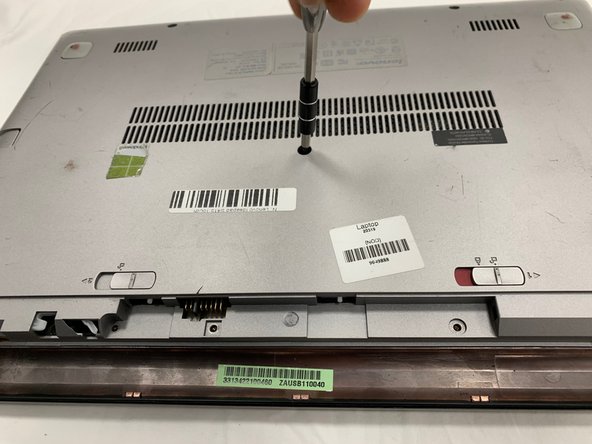

    • Locate the five black screws on the back.
    • Use a Phillips #0 screwdriver to remove all five black 6 mm screws.

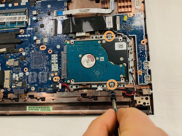

    • Locate the hard drive.
    • Use the Phillips #0 screwdriver to remove the two 4 mm screws that are holding the hard drive in place.
  11. Lenovo Ideapad S415 Touch Hard Drive Replacement: crwdns2935265:011crwdnd2935265:01crwdnd2935265:01crwdne2935265:0
    • The hard drive is now removed from the laptop.

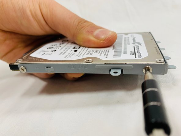

    • Once the hard drive is removed, locate the four screws that hold the metal frame to the hard drive.
    • Use the Phillips #0 screwdriver to remove the 4 mm silver screws on all sides.
