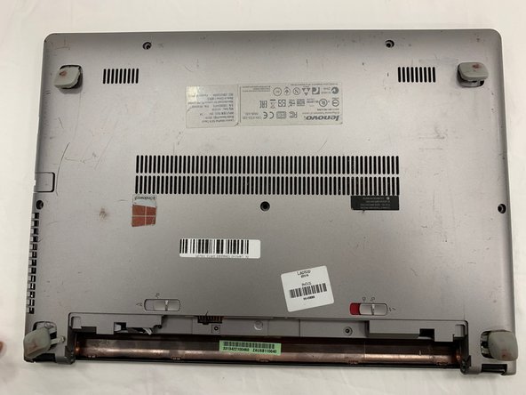

    • Flip laptop over bottom side up.
    • Locate the two battery release switches.
  2. Lenovo Ideapad S415 Touch Fan Replacement: crwdns2935265:02crwdnd2935265:01crwdnd2935265:01crwdne2935265:0
    • Use your finger to push the battery release switch labeled "1." The red indicates that the switch is unlocked.
  3. Lenovo Ideapad S415 Touch Fan Replacement: crwdns2935265:03crwdnd2935265:01crwdnd2935265:01crwdne2935265:0
    • Use your finger to push the battery switch labeled "2."
  4. Lenovo Ideapad S415 Touch Fan Replacement: crwdns2935265:04crwdnd2935265:01crwdnd2935265:01crwdne2935265:0
    • Once both switches are unlocked, the battery will release.

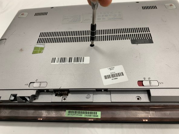

    • Locate the five 6mm black screws on the bottom.
    • Using a Phillips #0 screwdriver, remove all five black screws.

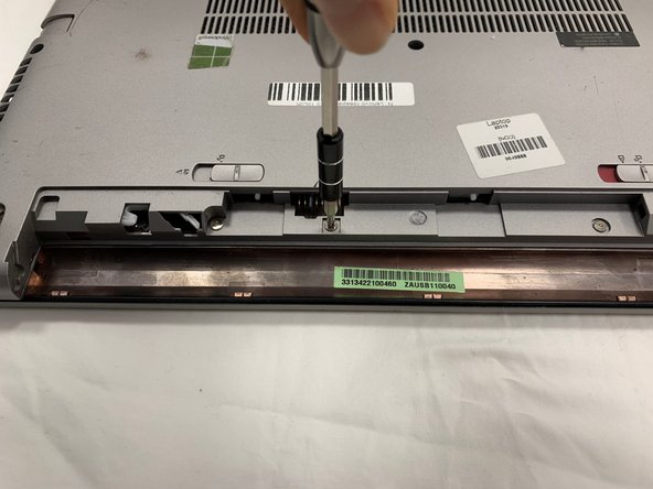

    • Locate the three 4mm silver screws on the bottom area where the battery was removed.
    • Using the Phillips #0 screwdriver, remove all three silver screws.

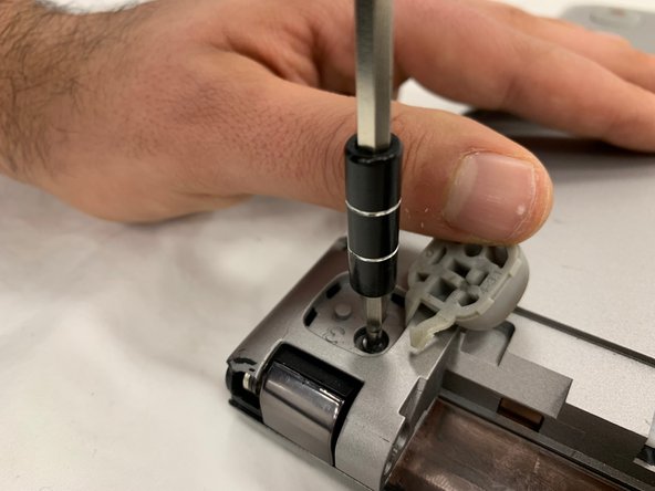

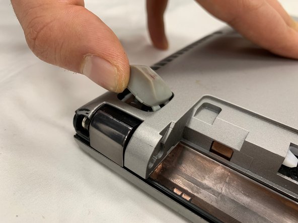

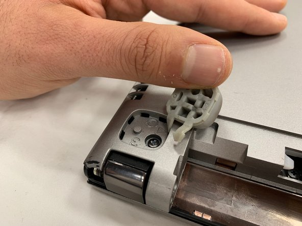

    • Locate the four rubber stoppers near each corner of the laptop.
    • Open up the stoppers by lifting each with your fingers.
  9. Lenovo Ideapad S415 Touch Fan Replacement: crwdns2935265:09crwdnd2935265:01crwdnd2935265:03crwdne2935265:0 Lenovo Ideapad S415 Touch Fan Replacement: crwdns2935265:09crwdnd2935265:02crwdnd2935265:03crwdne2935265:0 Lenovo Ideapad S415 Touch Fan Replacement: crwdns2935265:09crwdnd2935265:03crwdnd2935265:03crwdne2935265:0
    • Under each of the four stoppers, there will be a 6mm screw.
    • Use the Phillips #0 screwdriver to remove all four screws.

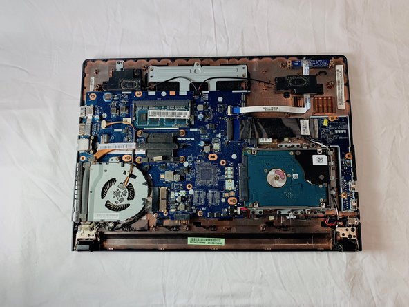

    • Carefully open up the laptop to reveal the internal components.
  11. Lenovo Ideapad S415 Touch Fan Replacement: crwdns2935265:011crwdnd2935265:01crwdnd2935265:02crwdne2935265:0 Lenovo Ideapad S415 Touch Fan Replacement: crwdns2935265:011crwdnd2935265:02crwdnd2935265:02crwdne2935265:0

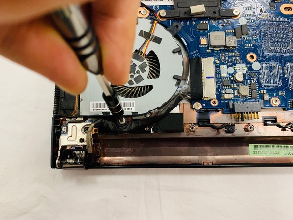

    • Locate the silver 6mm screw on the top of the fan
    • Locate the silver 4mm screw on the bottom of the fan
    • Use a Phillips #0 screwdriver to remove both screws.
  12. Lenovo Ideapad S415 Touch Fan Replacement: crwdns2935265:012crwdnd2935265:01crwdnd2935265:02crwdne2935265:0 Lenovo Ideapad S415 Touch Fan Replacement: crwdns2935265:012crwdnd2935265:02crwdnd2935265:02crwdne2935265:0

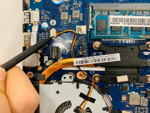

    • Locate the fan power connector.
    • Use a spudger or your hands to disconnect the fan power connector from its port.

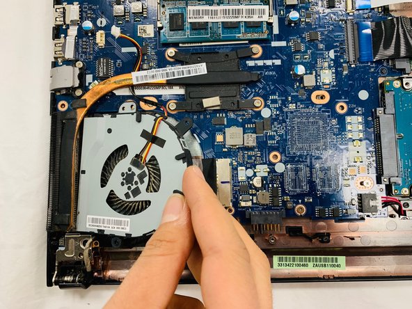

  13. Lenovo Ideapad S415 Touch Fan Replacement: crwdns2935265:013crwdnd2935265:01crwdnd2935265:02crwdne2935265:0 Lenovo Ideapad S415 Touch Fan Replacement: crwdns2935265:013crwdnd2935265:02crwdnd2935265:02crwdne2935265:0
    • Once the fan power connector is disconnected, lift up the bronze heatsink and pull the wires out from underneath it.
    • Lift up the fan and pull free.
