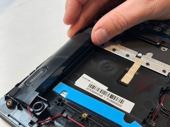

  4. Lenovo Ideapad Flex 4-1570 Speakers Replacement, Speakers: crwdns2935265:04crwdnd2935265:01crwdnd2935265:02crwdne2935265:0 Lenovo Ideapad Flex 4-1570 Speakers Replacement, Speakers: crwdns2935265:04crwdnd2935265:02crwdnd2935265:02crwdne2935265:0
    • Lift up on each speaker, one by one. The speaker should lift up with ease.

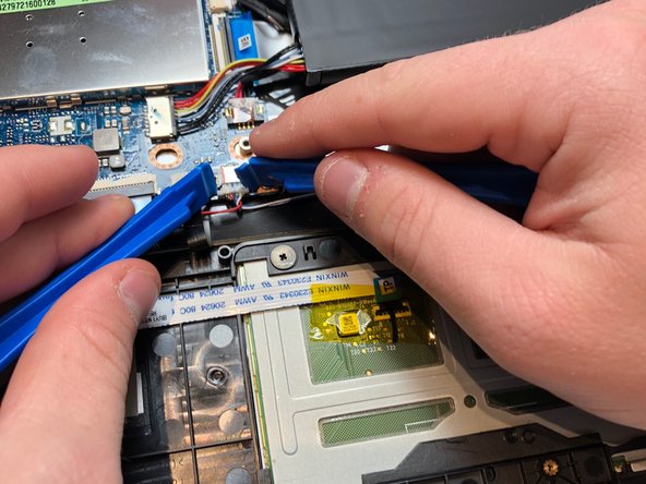

  5. Lenovo Ideapad Flex 4-1570 Speakers Replacement: crwdns2935265:05crwdnd2935265:01crwdnd2935265:02crwdne2935265:0 Lenovo Ideapad Flex 4-1570 Speakers Replacement: crwdns2935265:05crwdnd2935265:02crwdnd2935265:02crwdne2935265:0
    • Unwind the speaker wire from the plastic brackets. Once you have the wire completely unwinded, use two blue iFixit tools to disconnect the speaker chip from the motherboard.
