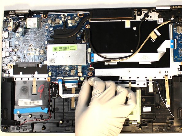

  4. Lenovo Ideapad Flex 4-1570 Motherboard Replacement, Battery: crwdns2935265:04crwdnd2935265:01crwdnd2935265:02crwdne2935265:0 Lenovo Ideapad Flex 4-1570 Motherboard Replacement, Battery: crwdns2935265:04crwdnd2935265:02crwdnd2935265:02crwdne2935265:0
    • Disconnect the battery by using a plastic opening tool or your fingers to push the connector towards the battery.
    • Do not pry or pull on the socket itself or you risk damaging the motherboard.

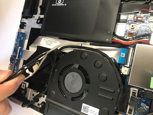

  9. Lenovo Ideapad Flex 4-1570 Motherboard Replacement, Cooling Fan: crwdns2935265:09crwdnd2935265:01crwdnd2935265:02crwdne2935265:0 Lenovo Ideapad Flex 4-1570 Motherboard Replacement, Cooling Fan: crwdns2935265:09crwdnd2935265:02crwdnd2935265:02crwdne2935265:0
    • Remove the three 5mm screws using the T5 Torx Screwdriver.
  10. Lenovo Ideapad Flex 4-1570 Motherboard Replacement: crwdns2935265:010crwdnd2935265:01crwdnd2935265:02crwdne2935265:0 Lenovo Ideapad Flex 4-1570 Motherboard Replacement: crwdns2935265:010crwdnd2935265:02crwdnd2935265:02crwdne2935265:0

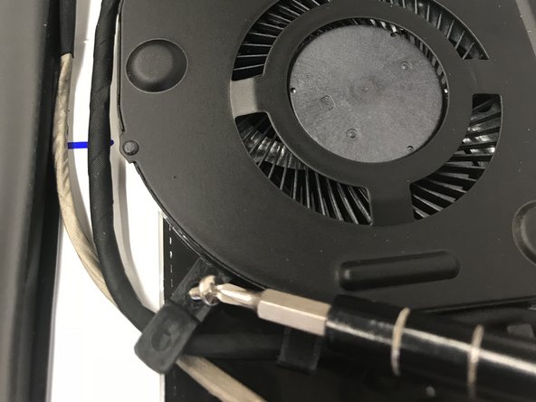

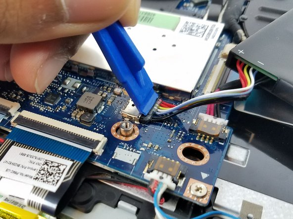

    • Pull black wire and gray wire away from cooling fan clips using the tweezers.

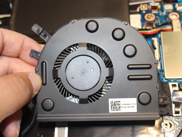

  11. Lenovo Ideapad Flex 4-1570 Motherboard Replacement: crwdns2935265:011crwdnd2935265:01crwdnd2935265:03crwdne2935265:0 Lenovo Ideapad Flex 4-1570 Motherboard Replacement: crwdns2935265:011crwdnd2935265:02crwdnd2935265:03crwdne2935265:0 Lenovo Ideapad Flex 4-1570 Motherboard Replacement: crwdns2935265:011crwdnd2935265:03crwdnd2935265:03crwdne2935265:0

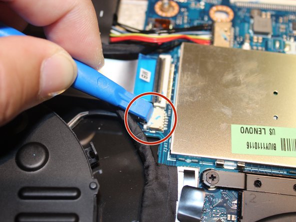

    • Pull out the cooling fan from where it is attached and pull it up until you see where the wire is attached to the motherboard. Using the iFixit Opening Tools, detach the connector.

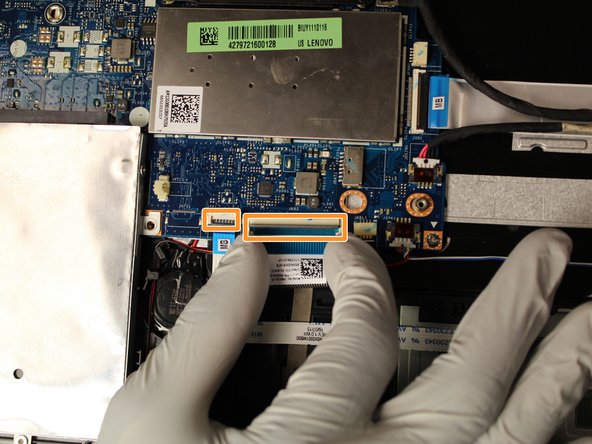

  12. Lenovo Ideapad Flex 4-1570 Motherboard Replacement, Motherboard: crwdns2935265:012crwdnd2935265:01crwdnd2935265:03crwdne2935265:0 Lenovo Ideapad Flex 4-1570 Motherboard Replacement, Motherboard: crwdns2935265:012crwdnd2935265:02crwdnd2935265:03crwdne2935265:0 Lenovo Ideapad Flex 4-1570 Motherboard Replacement, Motherboard: crwdns2935265:012crwdnd2935265:03crwdnd2935265:03crwdne2935265:0
    • Grip the plugs, then gently pull the three cables directly out of their motherboard ports.
    • Flip up the black lock-bars on the three ZIF connectors, then gently pull the ribbon cables directly out of their ports.

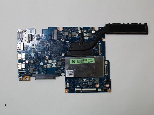

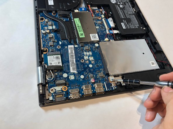

  13. Lenovo Ideapad Flex 4-1570 Motherboard Replacement: crwdns2935265:013crwdnd2935265:01crwdnd2935265:02crwdne2935265:0 Lenovo Ideapad Flex 4-1570 Motherboard Replacement: crwdns2935265:013crwdnd2935265:02crwdnd2935265:02crwdne2935265:0
    • Use a T5 Torx screwdriver to remove the three 4 mm screws.
    • Lift the motherboard up and out of the chassis.
