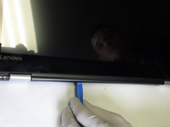

  4. Lenovo Ideapad Flex 4-1570 Display Replacement, Display: crwdns2935265:04crwdnd2935265:01crwdnd2935265:02crwdne2935265:0 Lenovo Ideapad Flex 4-1570 Display Replacement, Display: crwdns2935265:04crwdnd2935265:02crwdnd2935265:02crwdne2935265:0
    • Use an opening tool to remove the three hinge bezels.

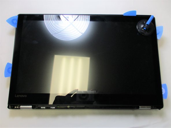

  6. Lenovo Ideapad Flex 4-1570 Display Replacement: crwdns2935265:06crwdnd2935265:01crwdnd2935265:03crwdne2935265:0 Lenovo Ideapad Flex 4-1570 Display Replacement: crwdns2935265:06crwdnd2935265:02crwdnd2935265:03crwdne2935265:0 Lenovo Ideapad Flex 4-1570 Display Replacement: crwdns2935265:06crwdnd2935265:03crwdnd2935265:03crwdne2935265:0
    • Attach a suction handle to the corner of the display, then wedge the blade of a Jimmy between the display and its housing.
    • While sliding the Jimmy around the perimeter, place opening picks in the gap you created at regular intervals.
    • Once you've worked around the perimeter, lightly pull on the suction handle while gently prying with an opening tool until the display releases.
